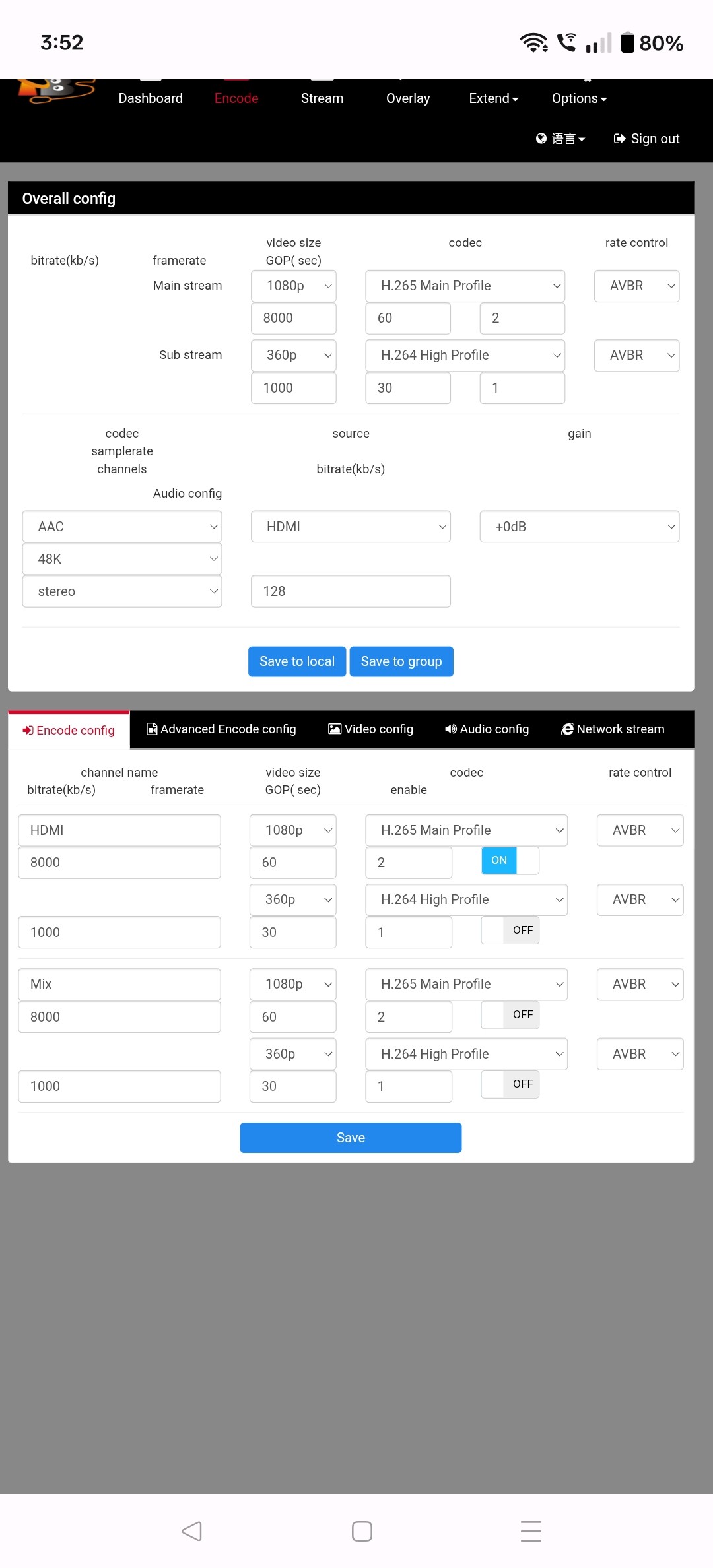

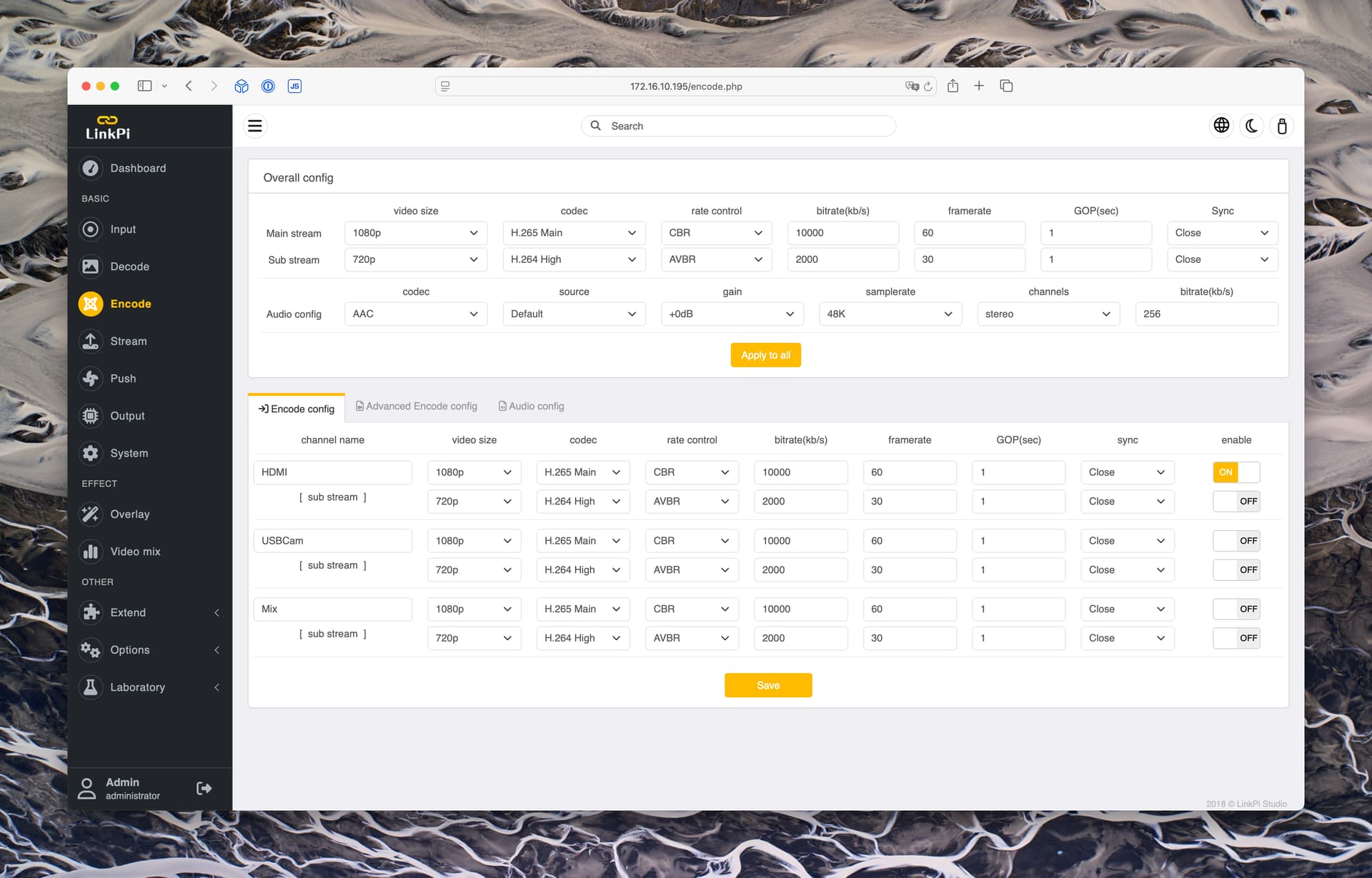

If so, can you take a screenshot of your Encode page? It should look something like this:

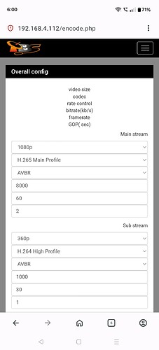

Here's my TBS encoder config, streaming TS.

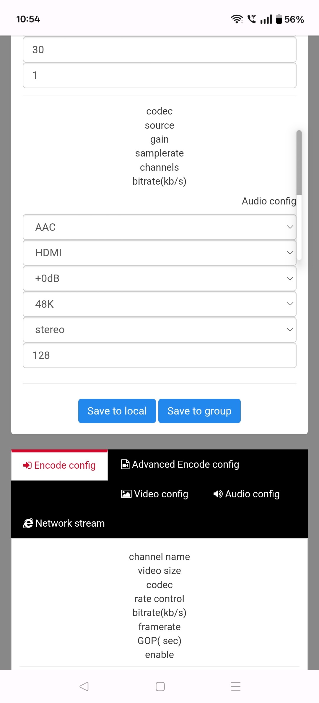

Can you scroll down further and take more screenshots?
Sure, here's the audio config, there's no other active video profiles. Anything else is disabled.

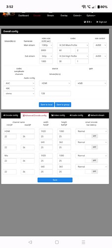

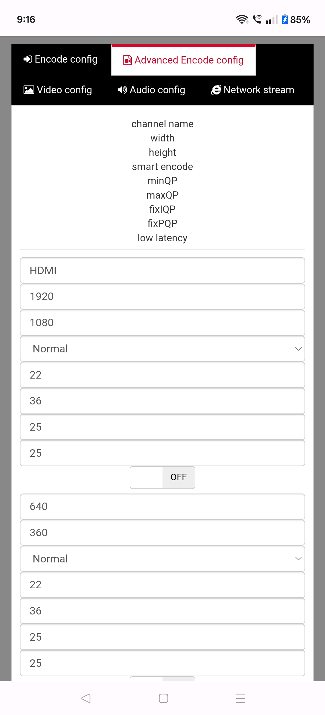

The thing I'm looking for is further down for the actual Encode Config.
This is the advanced encode config, there's nothing else.

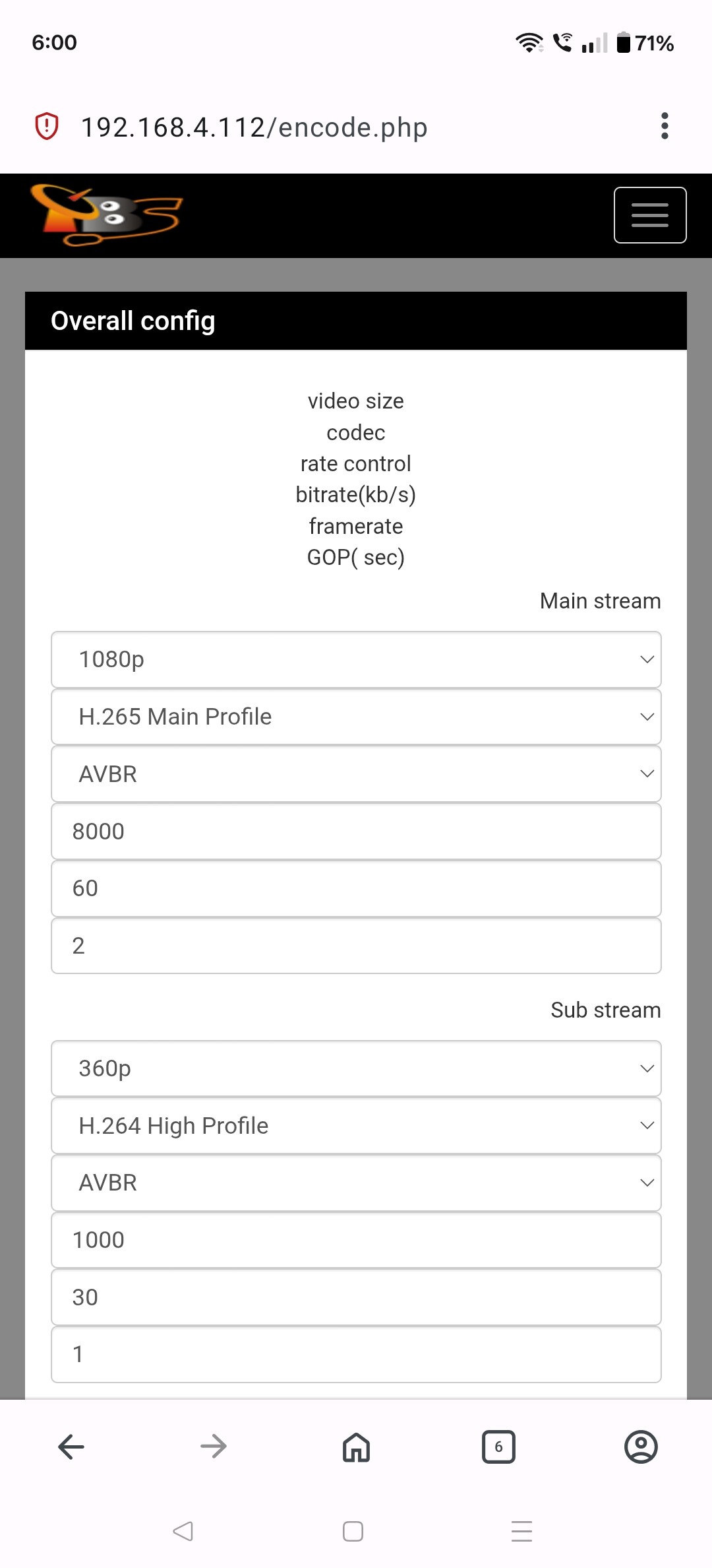

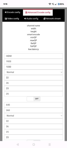

What about further down the page for the Encoding Config?
Here's the desktop view of both encoding pages, that's all there is.
Thanks. The second screenshot had what I was looking for.
I was able to reproduce something that sounded like what has been described on this thread when I had my video size set to Auto and then changed the resolution of the streaming device that was being captured. Once I changed the video size to 1080p it stopped exhibiting the issue.
