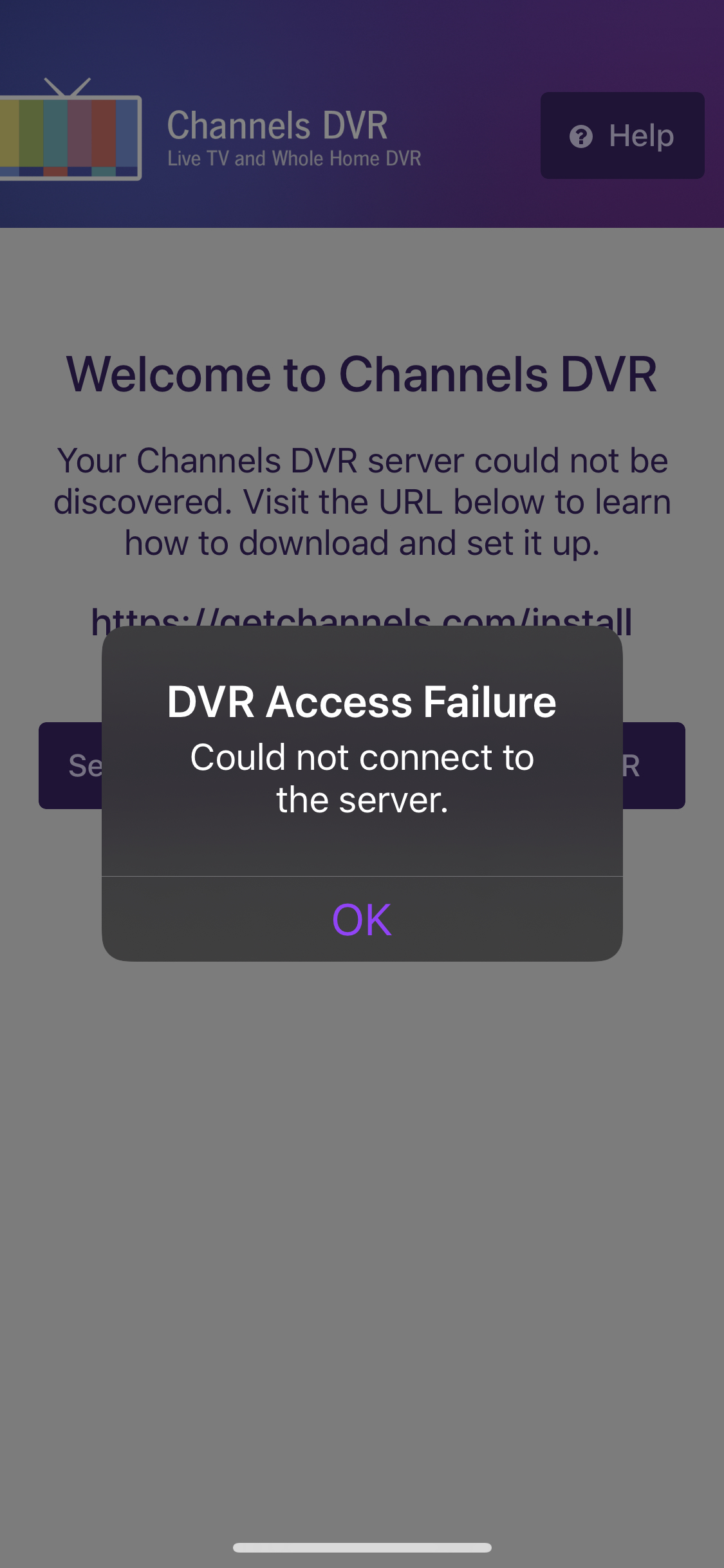

I'm trying to set up away from home, but it won't work. I've already set up port forwarding on my router, I've used a port checker to make sure the port is actually open, but when I try to connect via the Channels DVR ios Beta App, I get a message that says the DVR server can not be reached.

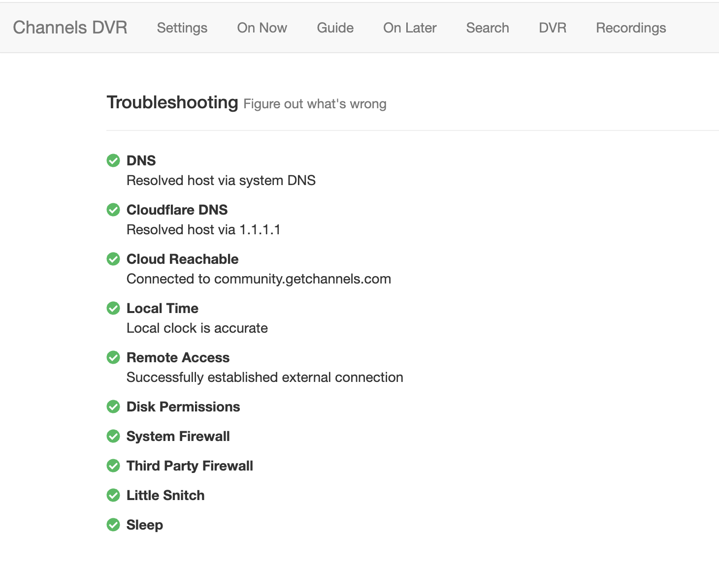

From your home network please visit http://[DVR-IP]:8089/admin/troubleshooting and see if it reports any issues.

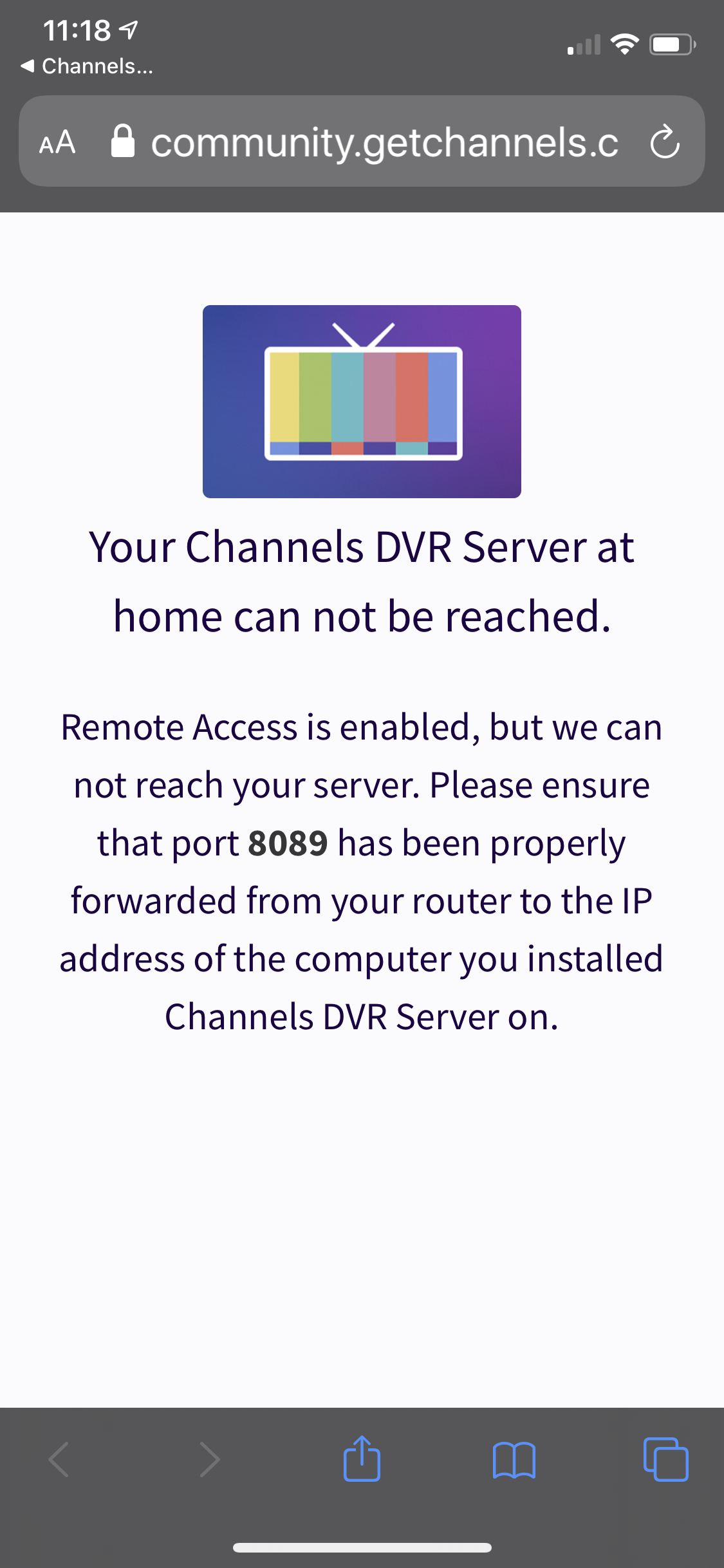

So I went back in, changed it back to automatic and removed the port forwarding. I then approved access from all the IP addresses that just came in trying to hit port 8089. I arrived at the authorization screen on the website, tapped on authorize, and then this came back when it switch back to the Channels app.
so it's closer, as the website can see my server, but now the app can't access it for some reason.
It all seems okay

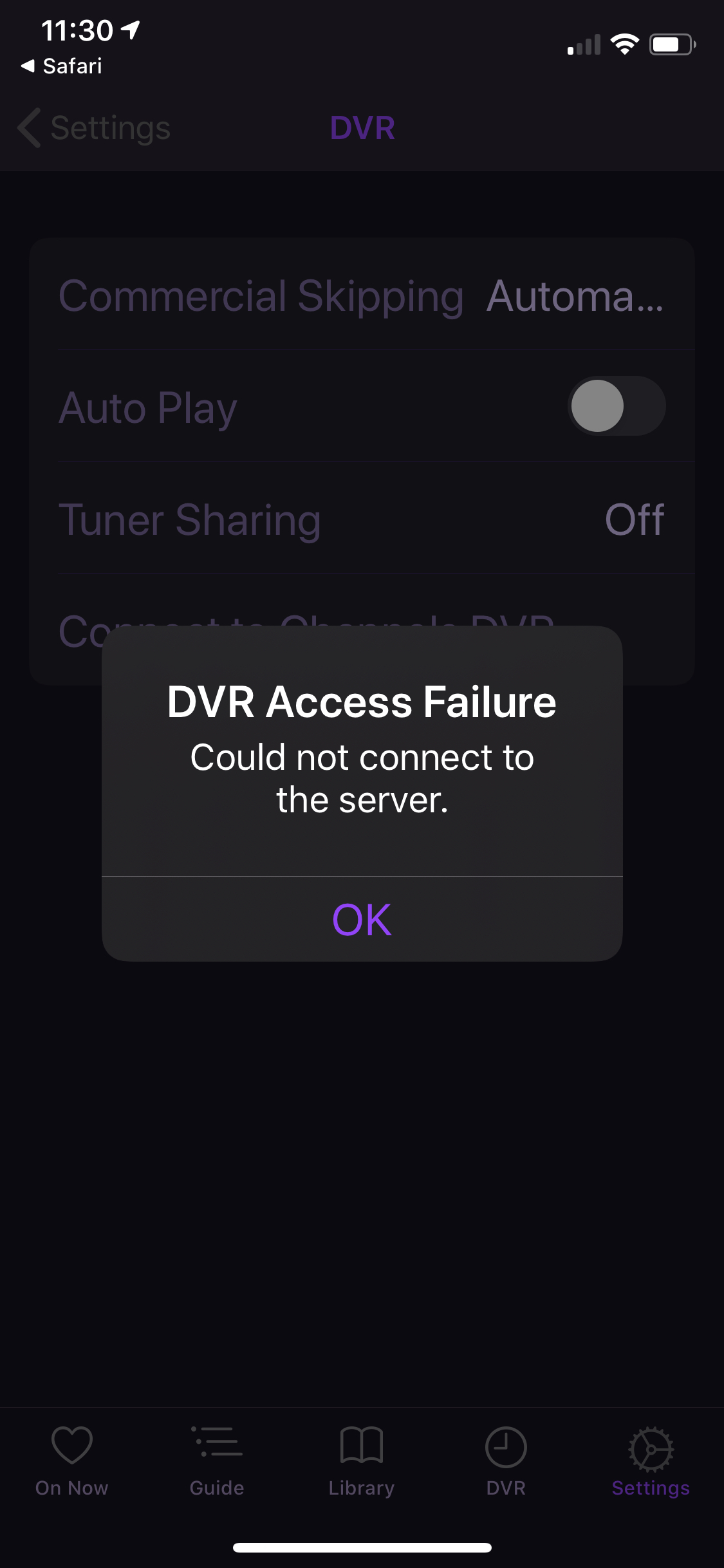

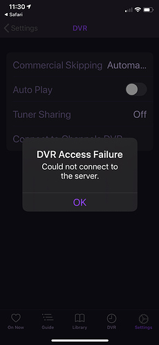

Oh, that would make sense. But, i'm getting the same error, but this time i'm using cellular (which is pretty weak inside the house)

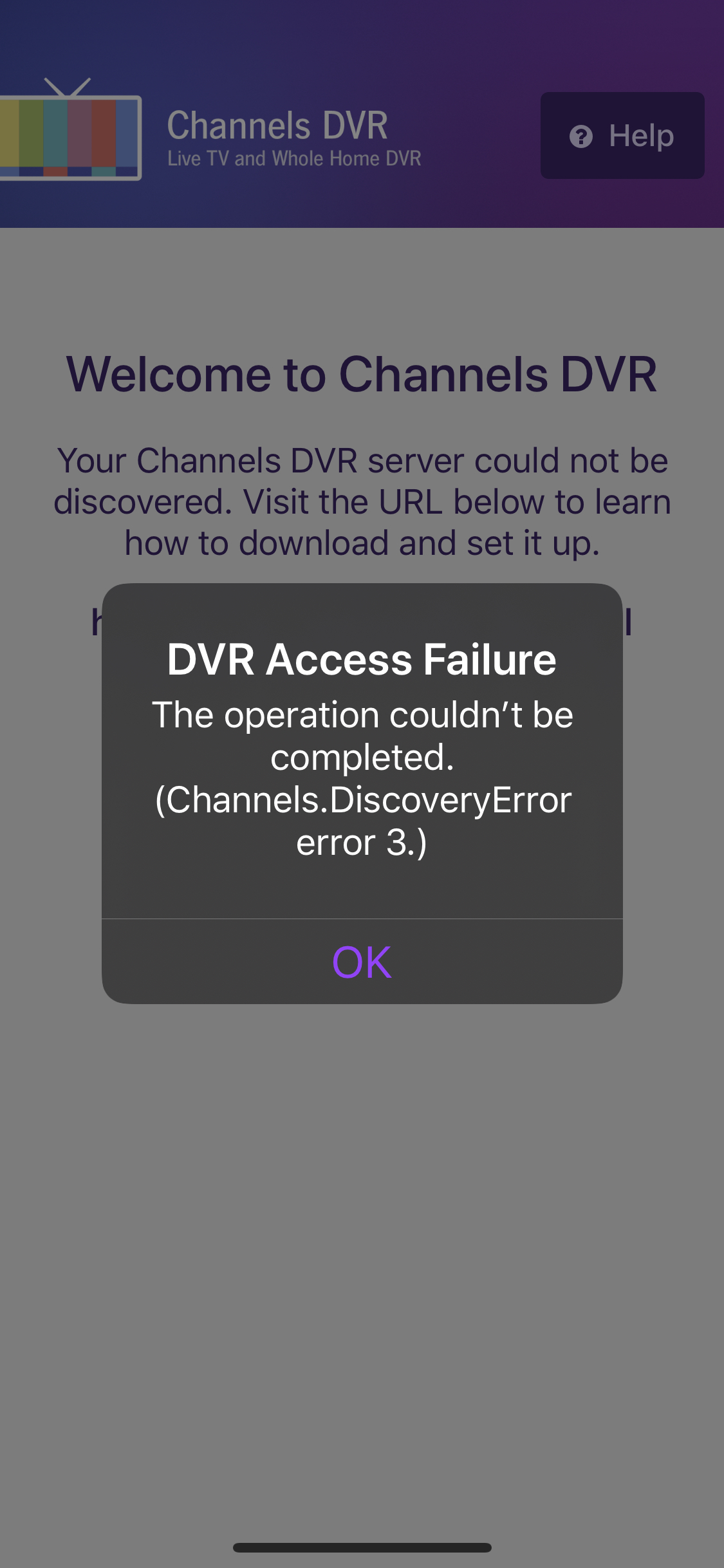

okay, just did it. Also, got a different error screen this time when trying to reconnect via cellular.
I didn't know which diagnostics to report, so I sent them all.
It looks like everything is setup correctly. I’m guessing you’re just running into your bad cell reception. If you are out of the house and with better reception everything should be working for you now.
