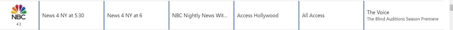

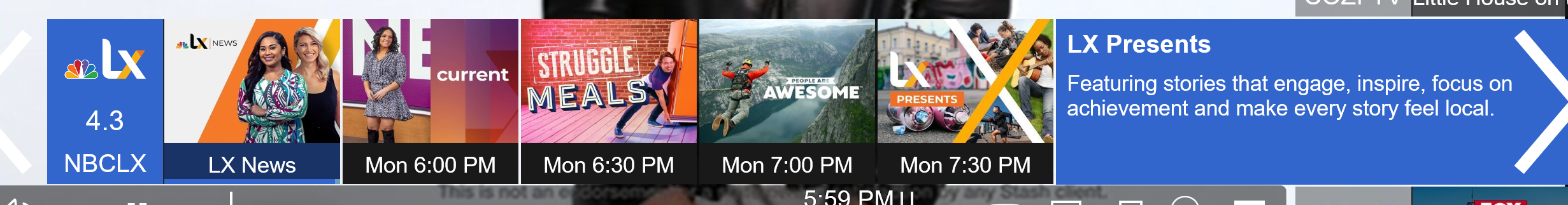

The Channels live TV guide seems to be pulling the wrong channel for OTA NBC LX.
This is what the HD Homerun is showing:
This is what Channels is showing:
Anything I can do to fix this?

You can try holding down SHIFT on your keyboard then click the Sync Mapping option next to your HDHR (on the DVR web UI sources list).
That fixed it, thanks!
