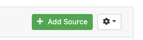

Then add the sources section of settings:
Tap 'add source'
Pick 'custom channels':
Then choose 'text' and put the code snippet above into the text box. You could put it in a file with .m3u extension and link to the path of that instead, but that's trickier.
