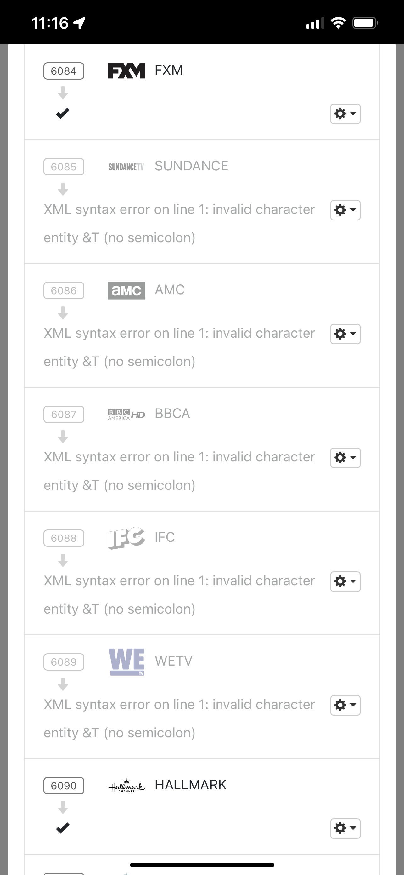

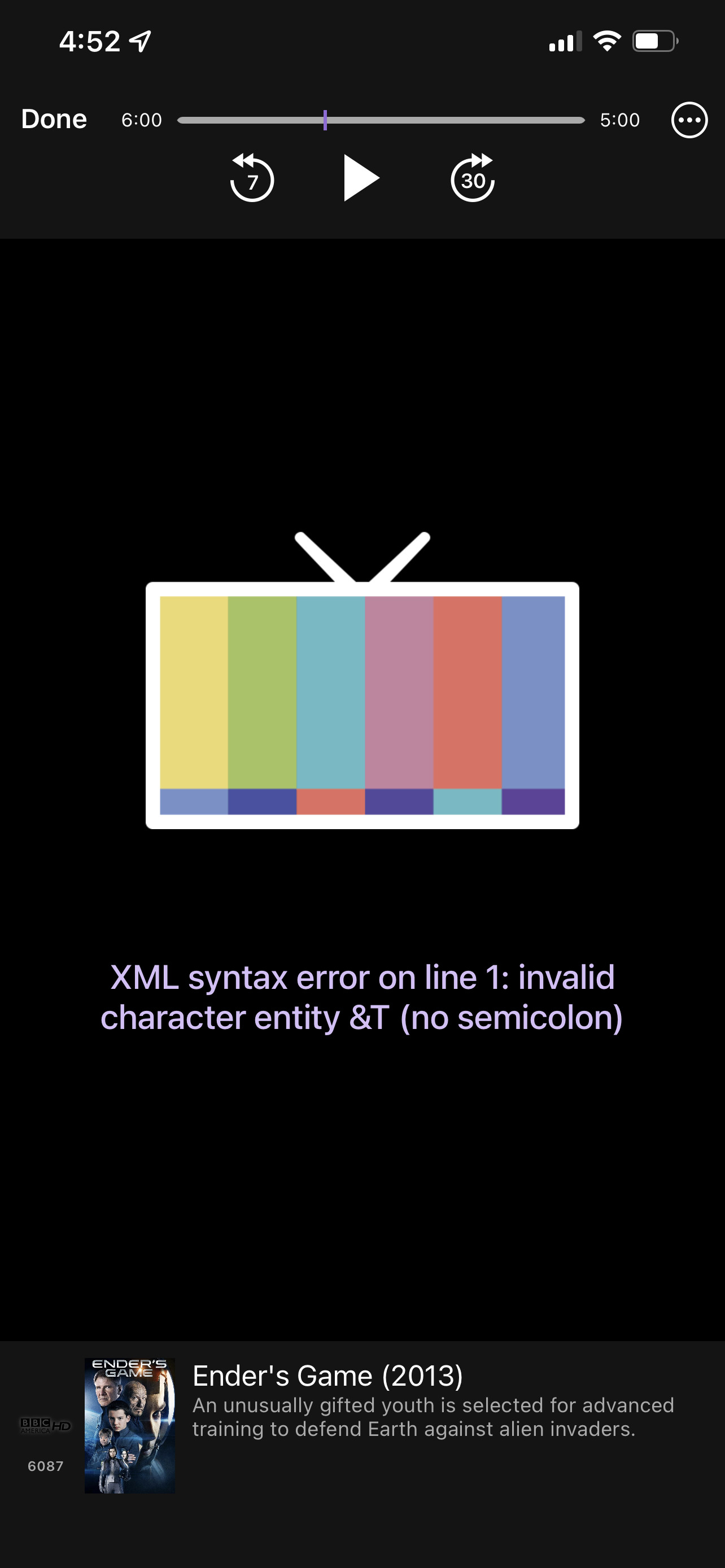

Getting this error when trying to watch BBC America. Using Version
2021.11.16.2141
Seems to be all the AMC channels around it too.

Please upgrade to v2021.11.17.0014 (in 20 min) and submit diagnostics from that build after trying to tune the channel again.
Logs have been submitted as 0fd074cc-4c50-46fa-8175-b32ddc190d9a

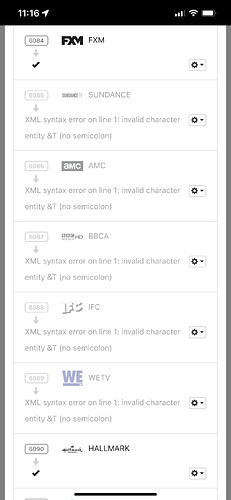

Sundance (6085) - WE (6089). Getting an xml error.

6085 SUNDANCE
6086 AMC
6087 BBCA
6088 IFC
6089 WETV
Logs submitted as 9888a281-d357-4f21-90d8-6662f20aded4

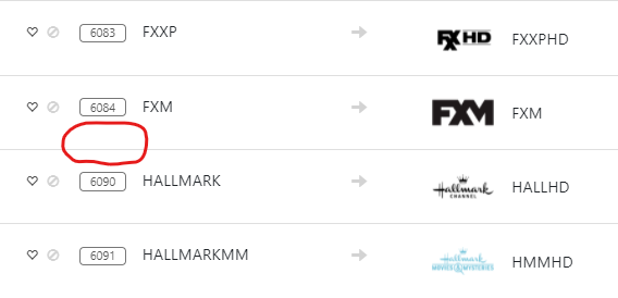

I just rescanned all my DirecTV channels and the AMC channels are gone, not even listed in the lineup anymore!
dtv_missing_amc_channels
Thanks for the diagnostics. Should be fixed in the latest build.
You have to go into the rescan lineup to see it.
