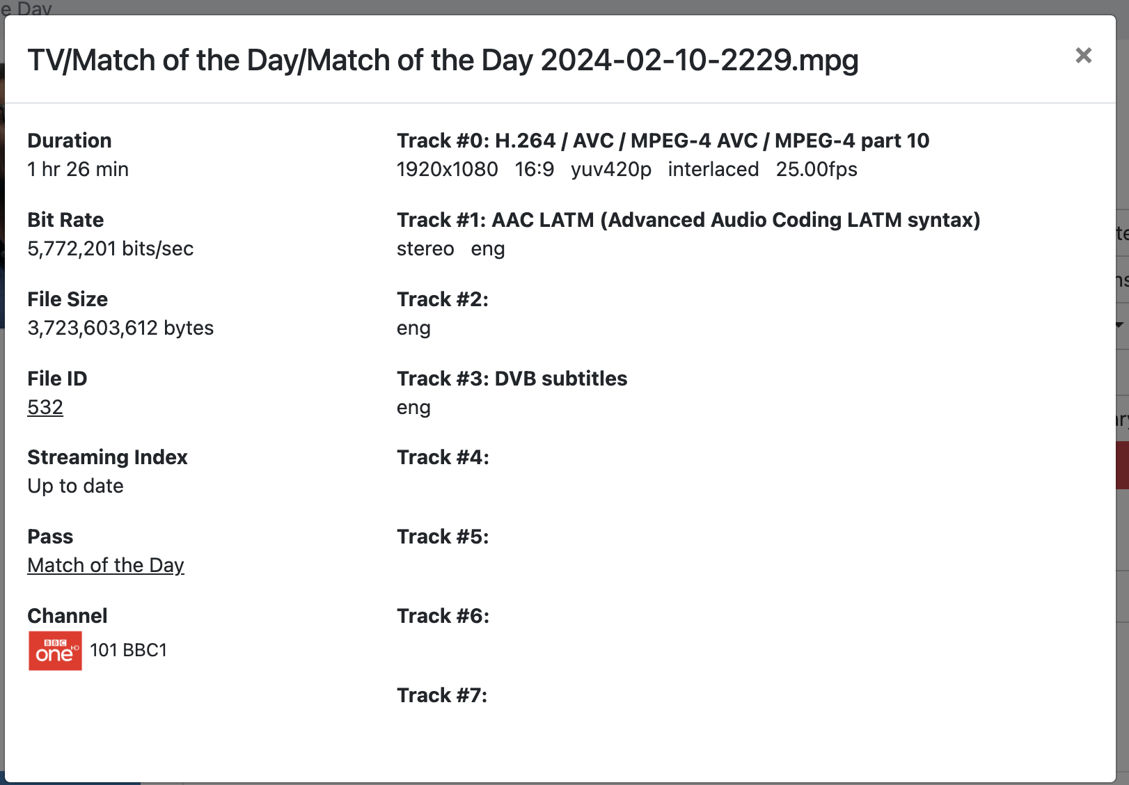

These are recordings via a freeview aerial?
What does View Details for one of them show on the web UI?

Yep via a freeview aerial
