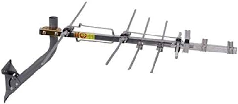

Stay away from the Yagi. They are a cheap rip-off the Winegard series.

"Yagi" is a type of antenna, not a brand name. If you stay away from Yagi antennas, you'll be excluding a ton of antennas.
Yes, I have two Yagi antennas. One pointed at Baltimore towers and the other at DC. All channels are perfect. All at 100% symbol quality. All of the local stations are at 100% signal strength too. No kind of amplifiers are used anywhere. These antennas are directional and will work significantly better than an omni-directional antenna as long as the towers you need are in the same place. You just need to point them in the right direction. I think they are better than any other type of antenna.
I think he was referring specifically to that RCA Yagi he provided a link for. I changed to a Yagi style and it was a huge improvement. Towers are 35 miles away and all in the same general direction. Winegard YA-7000C
