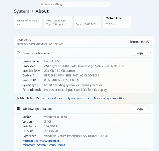

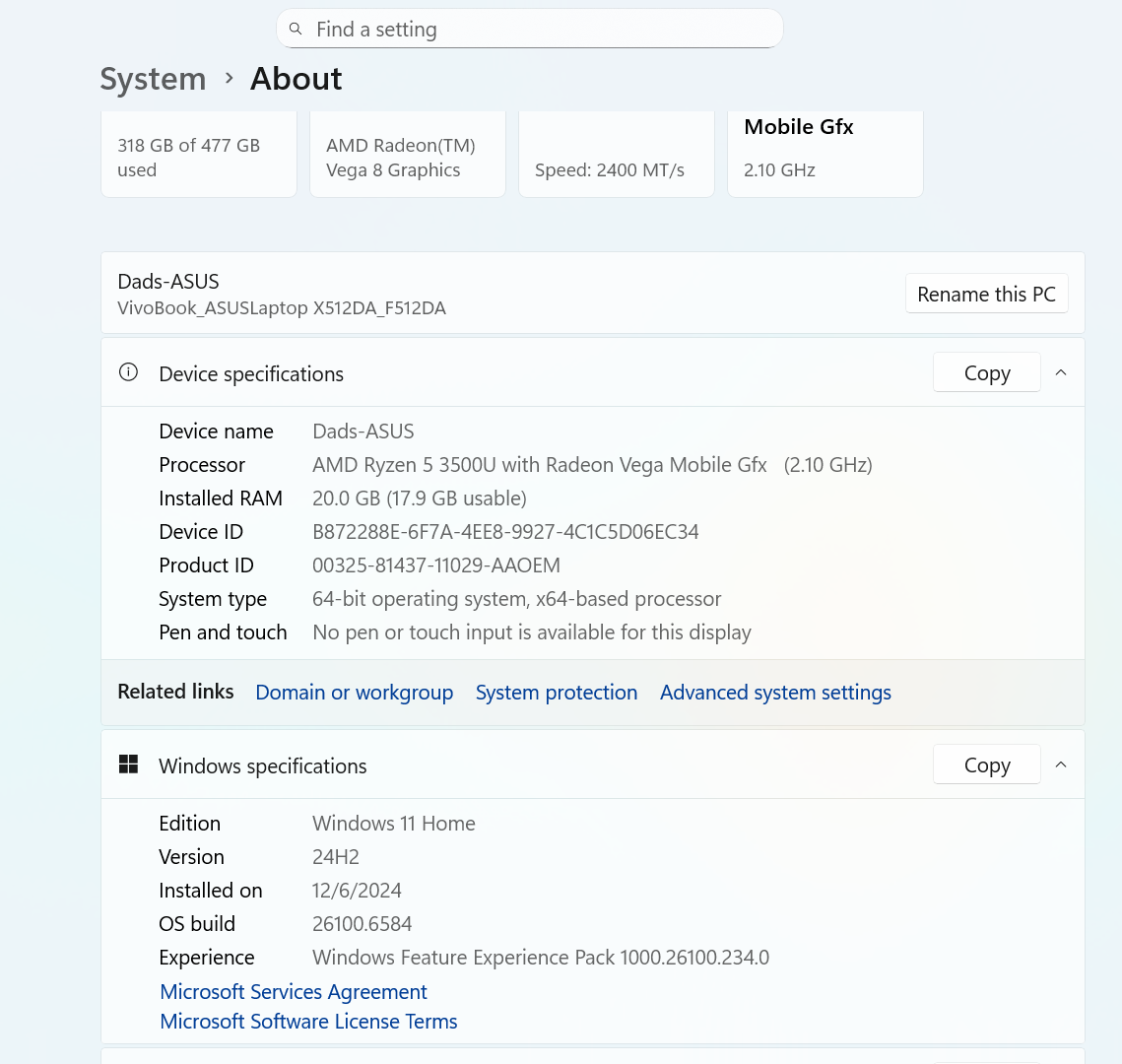

Thanks again. I realized that I have a seldom used laptop that also might serve. Having battery backup and dedicated screen would also be pluses. Do these specs look adequete? I would strip all other programs from the PC. Lew
