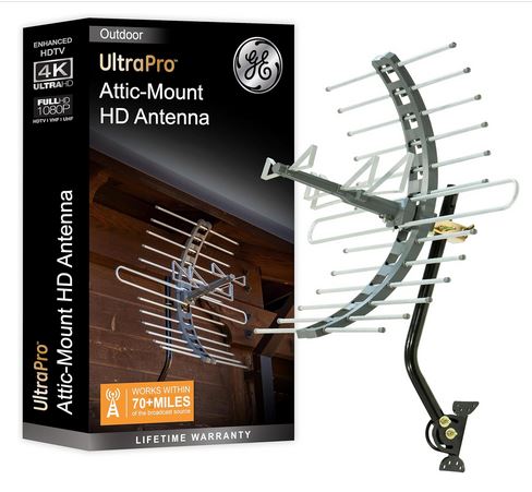

So far I mounted this one 1st antenna fairly high up the side of my house BUT not above main roof line....I can go higher with alot more effort etc so far i get 2-1 4-1 5-1 9-1 plus all extra channels on each band and a ton of others 52 in total if i add and antenna amp i can tune in 7-1 ..... or i can swap it for this one 2nd option Or maybe quit while im ahead????????
HD Homerun Connect Duo on order only 2 channels BUT i should be fine with it since i only need 4-1 5-1 for now Trying to keep the total cost under $100 which ive done so far
I'm not exactly a big fan of those no name antennas. Usually they're Chinese made pieces of crap. Something like this would probably do
https://a.co/d/eJpDDdF
Get an antenna from a reputable company like Winegard, antennas direct, Antop, Televes and Channel Master
The antenna you have is on the cheap side but hey it works. Its so cheap that if it breaks or you decide you need that other channel then just replace it with a better one.
i'm not going overboard on an antenna for just 2 channels etc This is working for now for cheap waiting on HD Homerun as final test

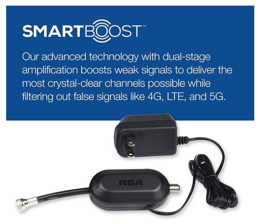

Got an older HDHR5 Connect Duo I can tune the 2 required channels "ok" 5-1 (Fox) shows signal quality is around 58% same for 4-1 (NBC) signal strength shows 77% and up Symbol is at 100% for all. After more research most websites recommend a small directional antenna with a Pre-Amp I found an RCA pre amp for $25 and it includes an FM filter as well as LTE 5G filters so I will get the ladder out later after Amazon shows up and see if that helps etc may swap antenna to the GE model I picked up for $35 while ladder is up etc.

Project is complete Installed the GE antenna with the RCA Amplifier/ LTE 5G filter and the HD Homerun Connect Duo ....All channels tune very well now. So I'm done for now......I hope

Its not bad. Hopefully for you, it'll last but I'm glad you got a good setup in order to stop relying too much on TVE to get locals...
RCA pre-amp is a sleeper - good and cheap. Ran one myself for years. Good luck!
