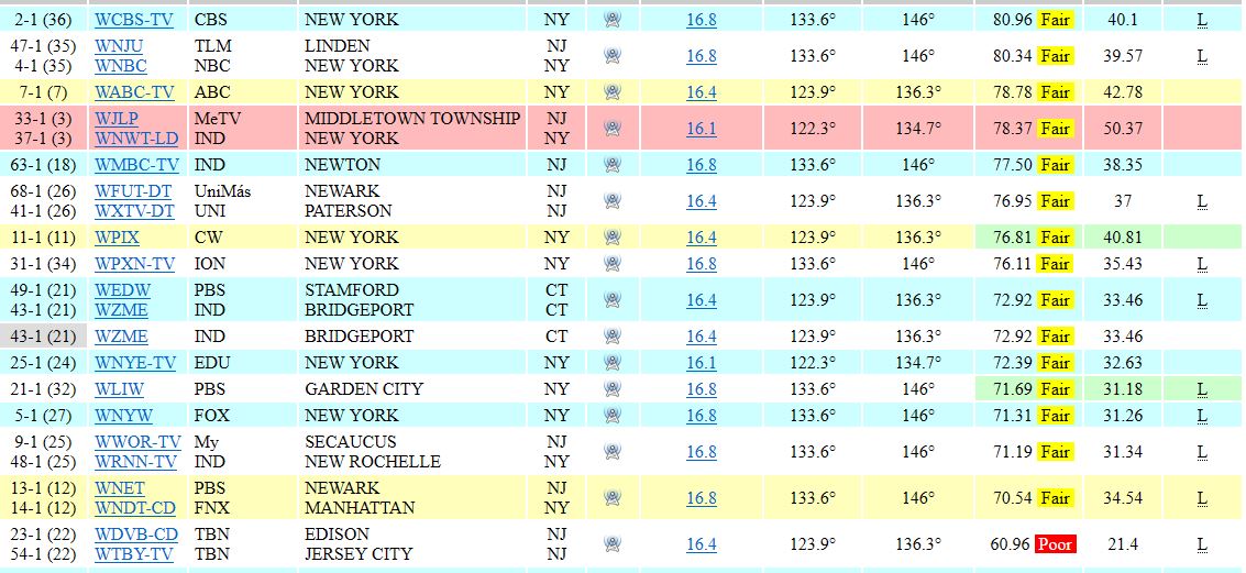

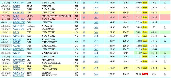

So judging by this scan I have 2 Low channels thus making this way more money than mounting a Yagi outside??? Or will thos 2 Not impact me too much???

50 miles away on Low VHF RF channel 3 could be hard to pickup reliably. How bad do you need those two stations?
You also have some (in yellow) on High VHF channels that requires an antenna designed for UHF and High VHF channels.
EDIT: Misread 50.37 (Noise Margin) as distance (actually 16.1 miles) instead of Noise Margin
That's a you question. Do you care about these stations or have other sources for them that it makes no difference?
It's still an antenna solution, just a more expensive/harder to find one that can handle low VHF frequencies (which the service I mentioned above does not offer, only high VHF + UHF).

I mainly need NBC and FOX for now the 2 in red i don't not have any use for nor need I just now made an antenna loop from some old coax and can pick up 2+ and 4+ and a bunch of others So making a true antenna or mounting it outside would probably work to pull in 7+ and 5+
