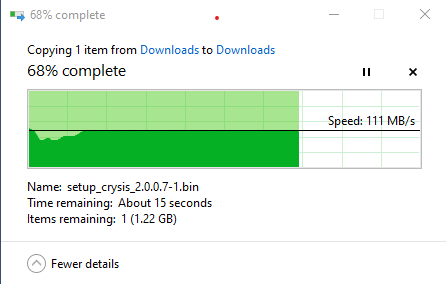

I concur with recommending the DS920+. I use mine in Raid 10 (disk mirroring + disk striping) with four 4TB WD hard drives for 8TB total storage. I get nearly 1Gb/s download and upload speeds since it doesn't need to calculate parity bits in Raid 10 = network speed limited.
See this test upload from my workstation PC to my DS920+ (111 MB/s = 0.89 Gb/s):
My NAS reports 117.4 MB/s = 0.94 Gb/s, which is probably more accurate than the Win10 indicated speed.

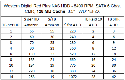

NetworkGuy recommends the better WD Red HD with 128MB cache. Oddly, it's much lower price on Amazon currently than the equivalent 64MB cache WD Red drives.
Also, after further investigation on my part and putting together this chart, I might convert to SHR the next time I decide to upsize my hard drives:
Yes, I'm a retired engineer with too much time on my hands.
