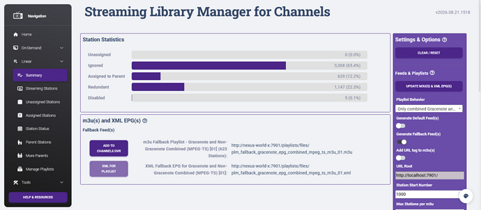

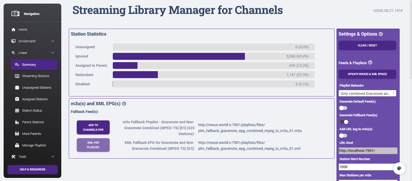

Actually, you don't! With the Fallback Feed, even with the rare instances Channels can't handle a HLS feed in a MPEG-TS playlist, PLM can automatically do it for you:
Also, there's some goodies coming in the next version that can help speed things up and deal with situations like my RTSP issue above...
The fix and benefits are in place as of v2026.09.12.1244 of PLM. Basically, there's an option that if a Parent only has one Child, then it will skip the PLM middle-man and do the direct link. This not only speeds up getting to unique sources, but also produces RTSP links so this is no longer a pressing concern from Channel's perspective.
