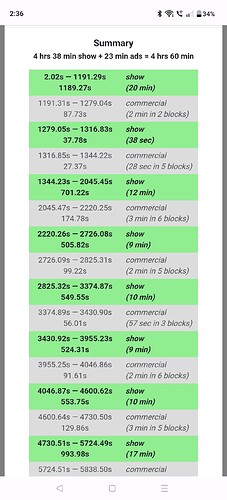

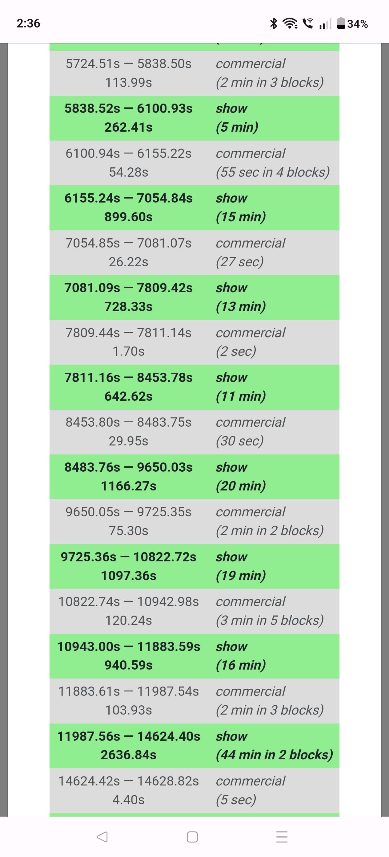

That's unfortunate, one of my common problems with sports events is that commercials are not flagged at all. In fact I just got done watching the women's British Open on USA Network and very few commercials were flagged. I'm running a relatively recent pre-release from July 26 so it had some of the improvements, but without a way to easily add in missed segments there's no way for me to help out the detection.
Thanks for responding.
Here's the summary for the event I just mentioned. The commercial blocks are way too short and at the end of the program almost nonexistent. I don't really understand why this routinely fails with sports because they all have logos that should be detected because they don't appear in commercials.
