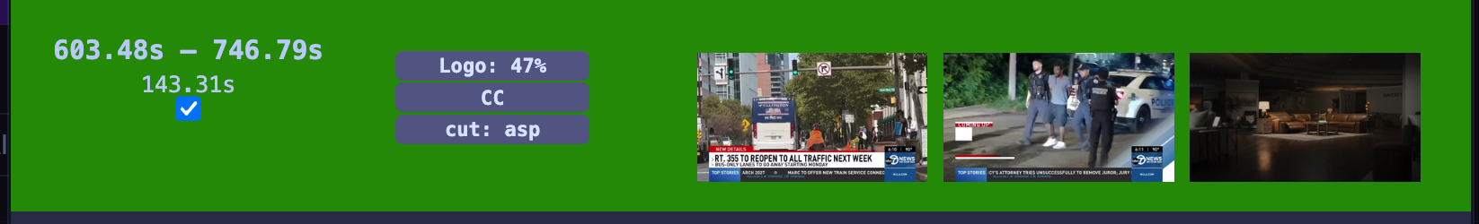

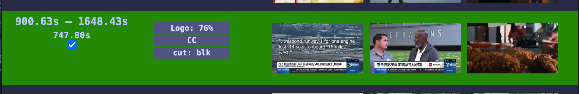

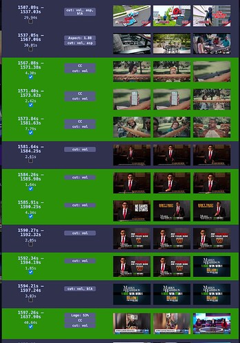

I really want to submit edits to try and improve the system, but every time I try, the blocks too long. When both the program and ads are in the same block, it's difficult to submit edits, in fact I usually cancel out of it because I don't want to submit bad data. At a high level, I've seen a small improvement compared to 6 months ago, but there are still far too many mistakes that cause me to either rewind because it skipped over the show, or manually skip forward because it missed commercials. I really hope further improvement can be made to this.
@sdschramm what sort of shows do you run into this on?
Mainly these two news programs:
Here are two examples where the program and a commercial are in the same block:

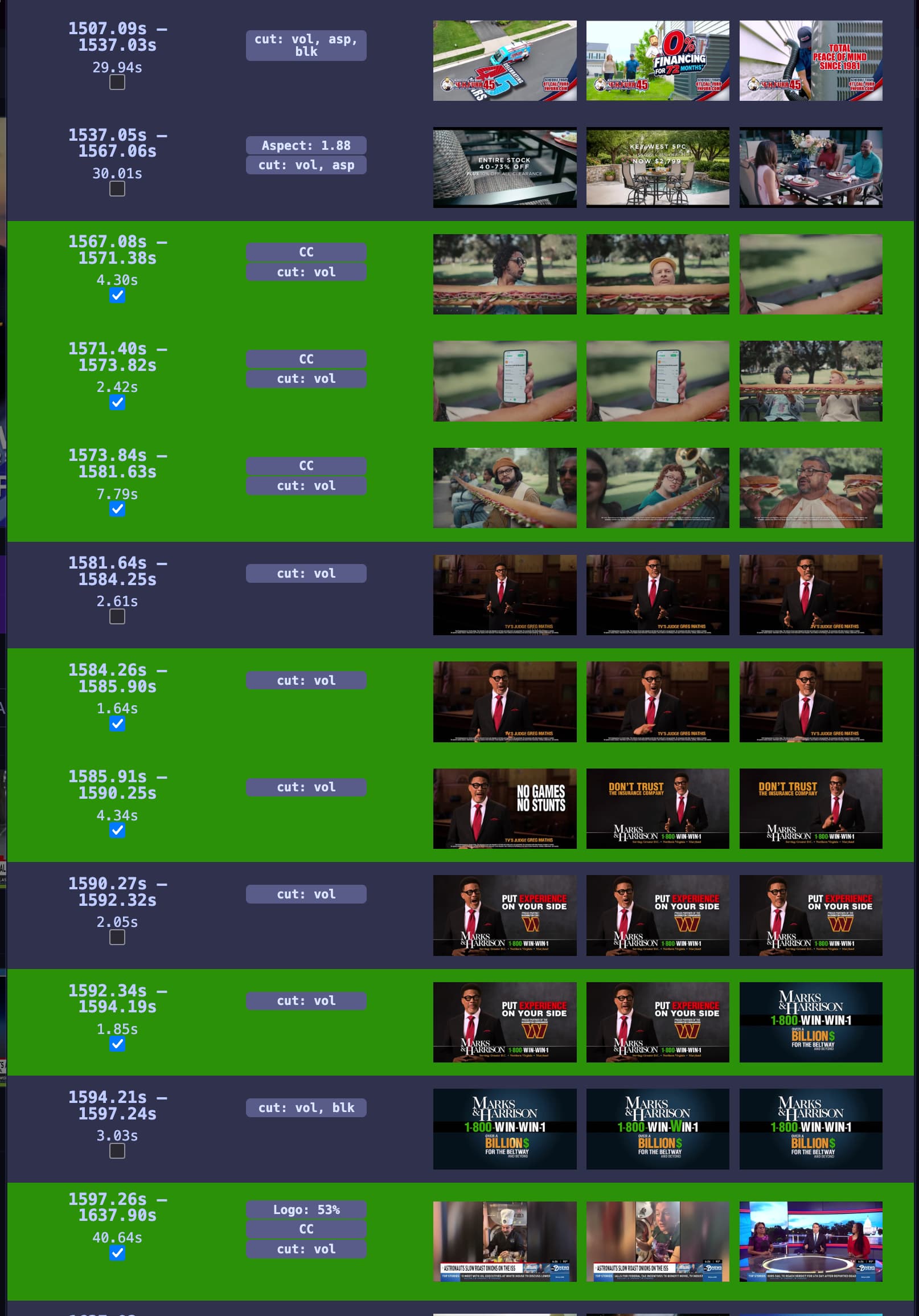

And sometimes it goes crazy and does things like this:
