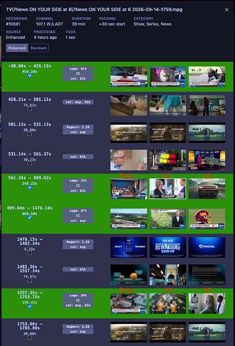

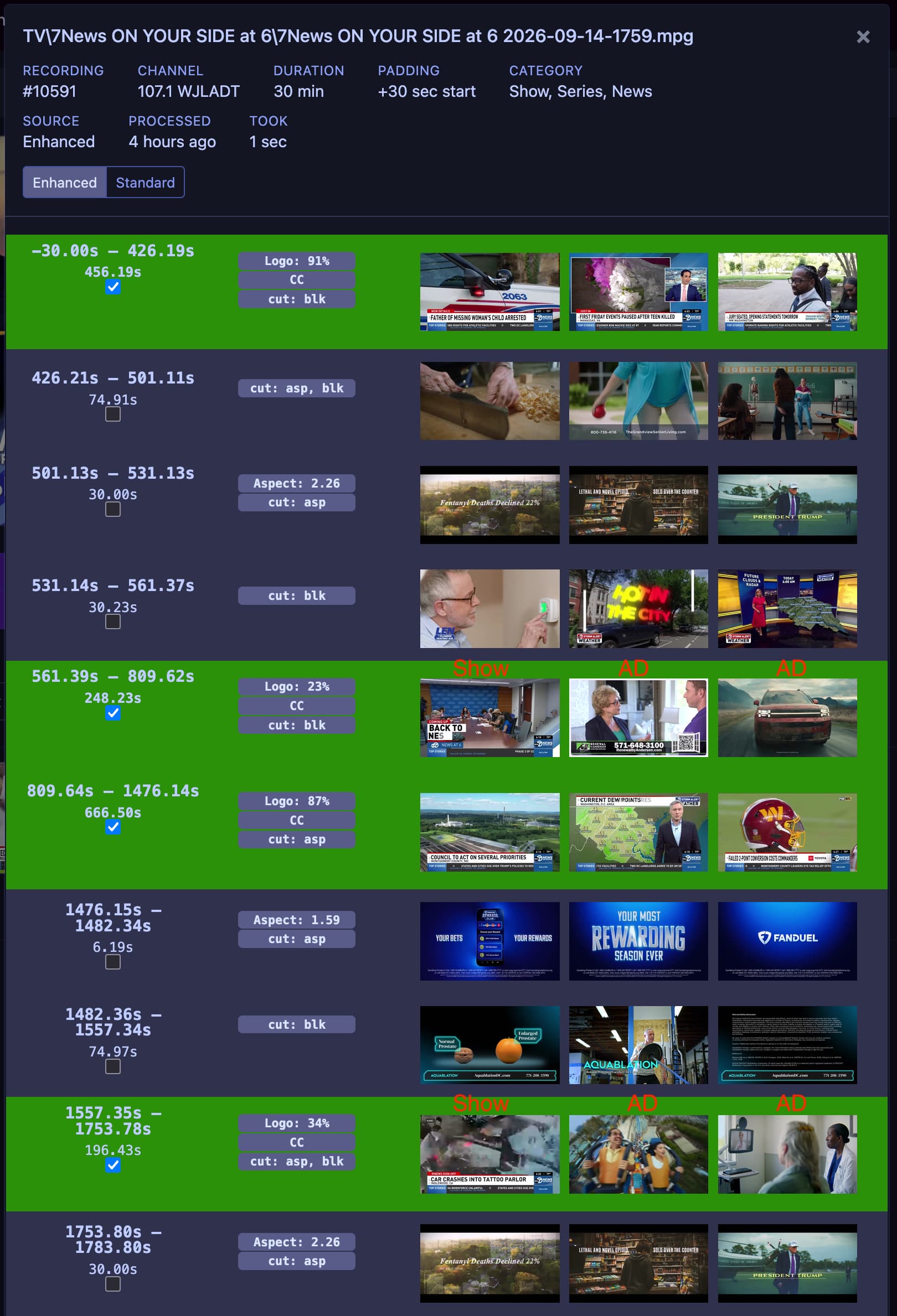

Sadly the issue is not fixed after the updates:
Another example from tonight:

seeing similar activity to @sdschramm but i'll submit as I can for a bigger sample size
Interesting that it seems to be these local news shows that are having the biggest issues. They're of course the hardest for me to test because I can't record them myself, but I'll keep these in mind.
The differences in commercial processing is wild.

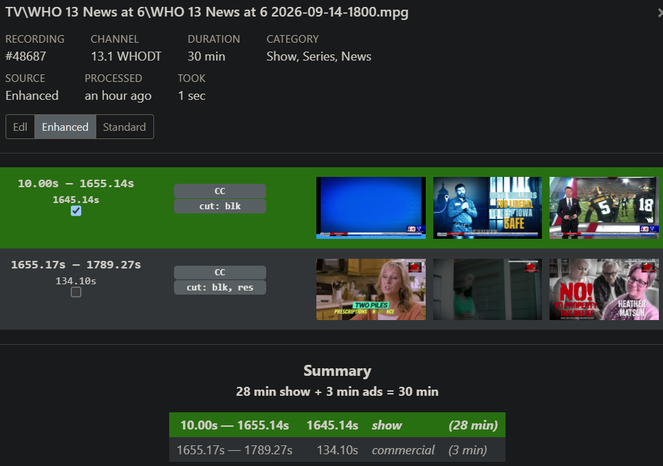

In @Shaggylive's example above, their recording was only cut into two blocks.
Meanwhile, in my it case, it decides to cut up one commercial into over a dozen segments and thinks only one of them is an ad.

Another example I can't verify and submit:
I'm not sure what it is you guys are doing since most of this thread is Greek to me, but I can tell you that comskip on World News Tonight has become almost flawless lately. So, thank you!
Yeah I'm seeing multiple of these shows now where ads are being intermixed with valid content, so you can't mark them correctly.
