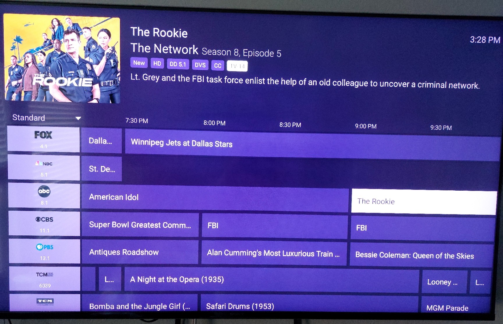

If I freshly launch the app (goes through complete startup routine) then all the guide data is present for all my channels. But if I play any channel, then back out of the app, then resume the app (doesn't go through the full startup routine), now I am missing the guide data beyond 4 hours for the recently played channel. The guide data doesn't return unless the app is forced closed and relaunched. Picture attached showing missing data for NBC.

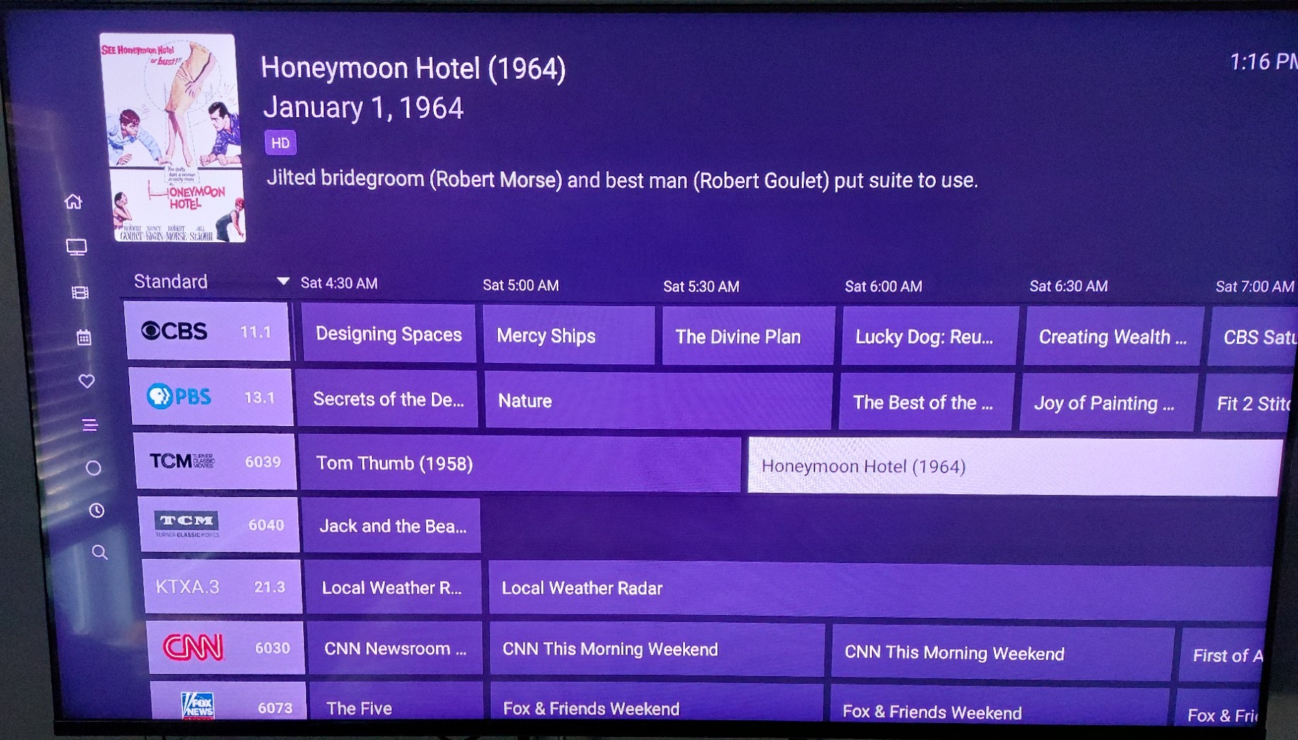

  2. After playing a live channel then backing out and resuming the app, I am still having intermittent guide blanking failures. It is not consistent anymore, sometimes the guide will go blank just about anywhere along the guide for the channel that was recently played. It wouldn't be so bad, but the blank area creates a wall that if your bump it then the app will crash to the OS. Picture attached. Diagnostics sent from the app after crash occurred.
