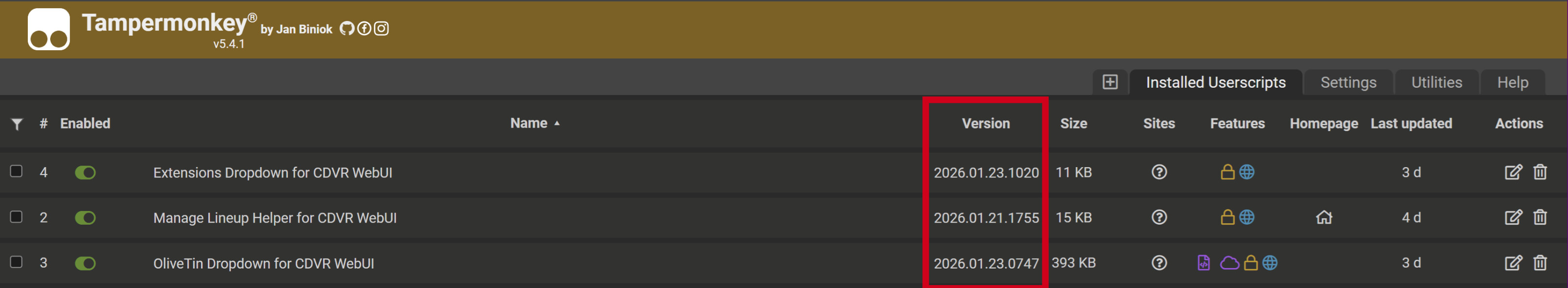

Could you confirm you're running the latest version of each of the scripts?:
Yes, those are the same versions I am running.

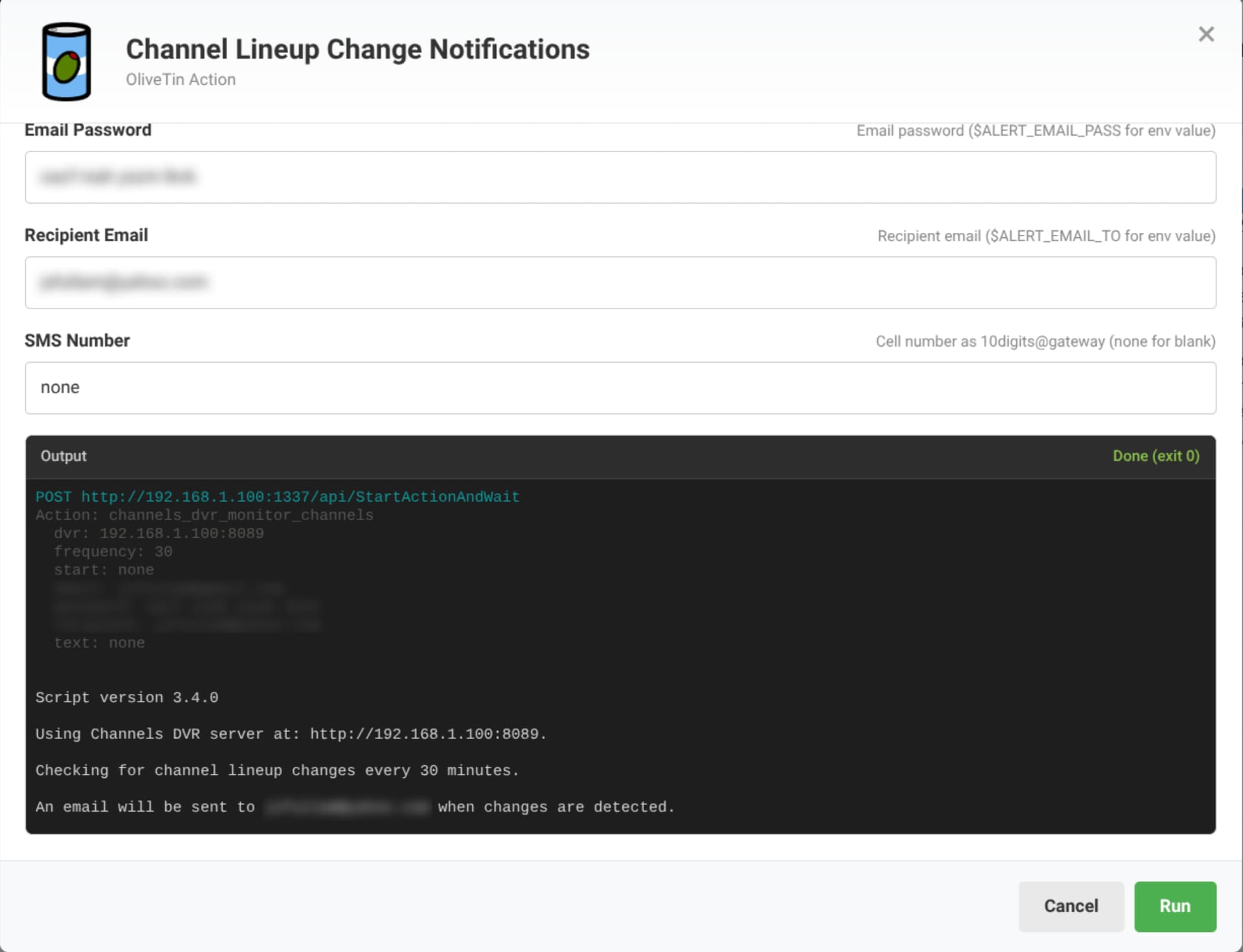

One thing I have noticed recently in my Olivetin GUI page, one of the icons is corrupted. I am actively running the "Channel Lineup Notifications" program. So, the action button on the interface should have the green icon. It has this instead:
Screenshot 2026-01-27 7.48.33 AM
I'll try closing the action and re-launching it to see if it updates.
After killing the action, the purple button icon came up.
Screenshot 2026-01-27 7.56.23 AM
I ran the Channel Lineup Monitor from the new CDVR GUI drop-down. It seems to have completed correctly.
Unfortunately, the green button did not update. I still am getting the corrupted image.
Screenshot 2026-01-27 7.59.38 AM
Thanks for reporting this. A few scripts were missed in the transition process. They should be OK now, so Re-pull and redeploy and let me know how it goes.
That did the trick. Thanks!
