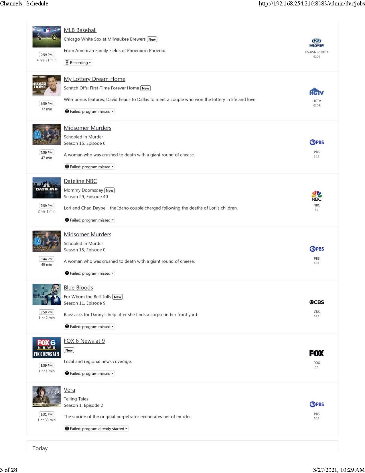

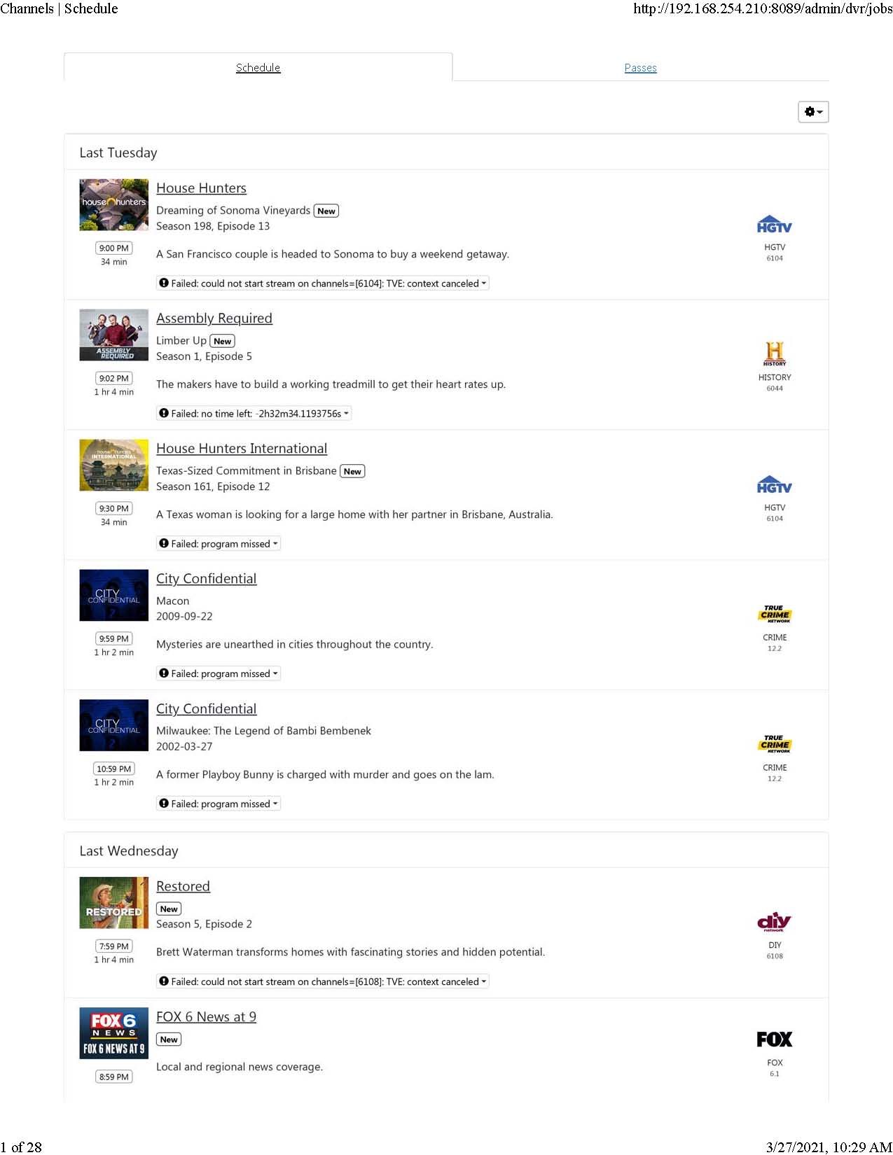

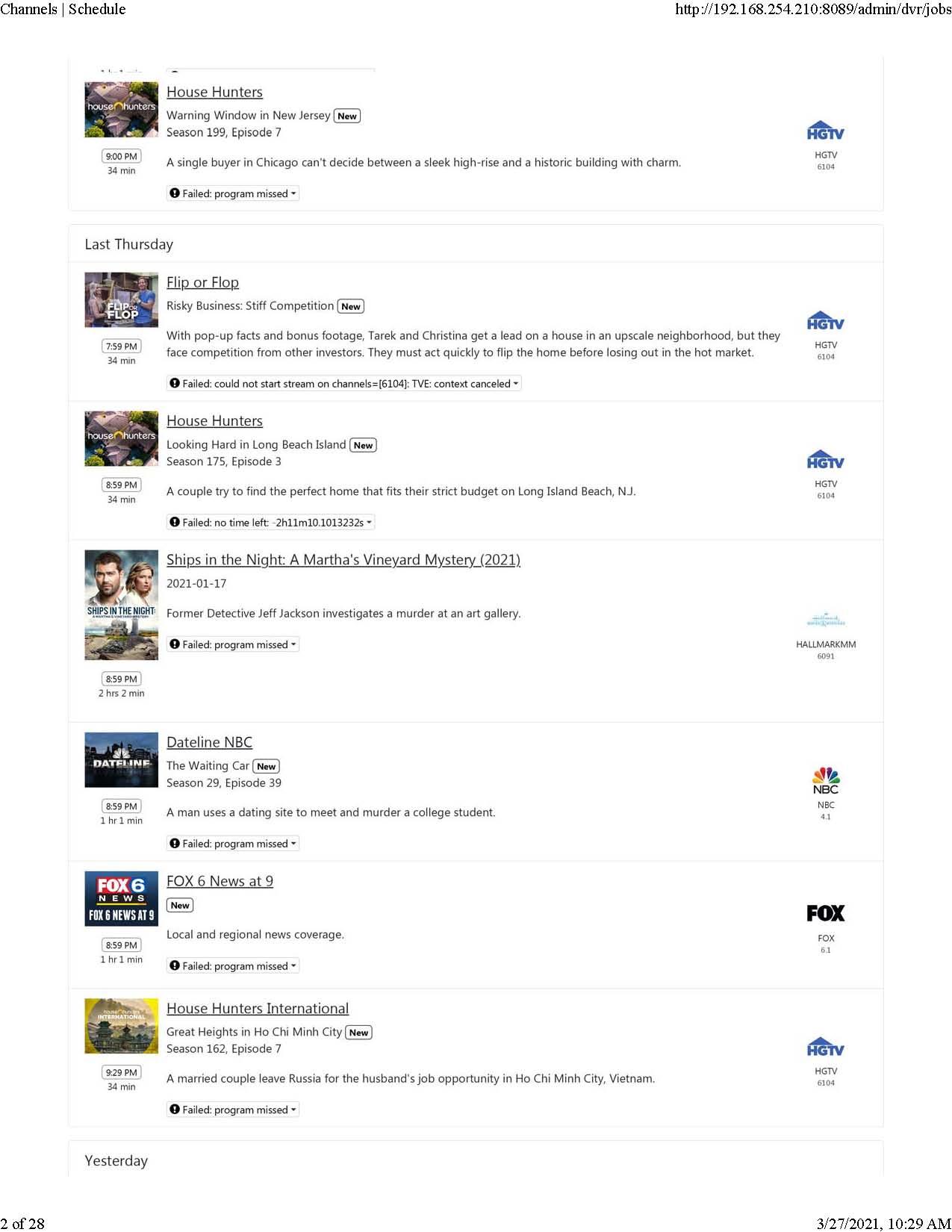

I have had Blue Bloods as a season pass (first runs) for a long time, and it's worked fine. How do I determine why it didn't record last night?
If it was in fact scheduled, it would show in the schedule as failed and give a reason.
If it wasn’t scheduled, then it wouldn’t and that would point to your pass being incorrect or the metadata of the airing being incorrect so that the pass did not schedule it.
