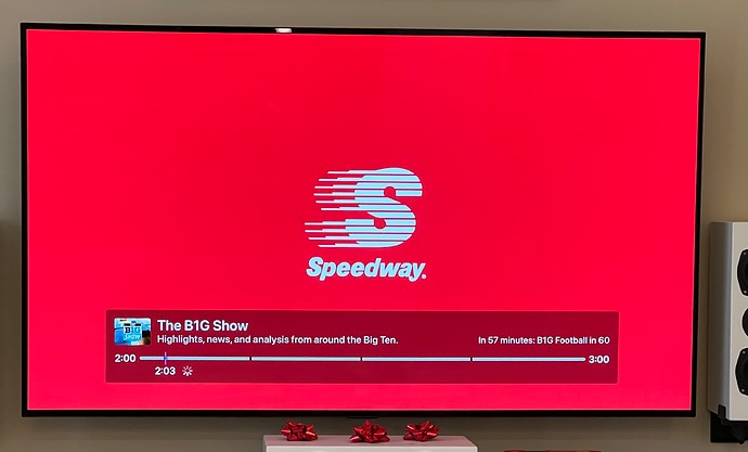

BigTenNetwork (BTN) via YouTubeTV / TVE ch 6199 commonly (75% + of the time) freezes / gets stuck for me via live TV or Recorded TV. The timeline scrubber just spins away... Seems to be on a "Speedway" commercial. It ruins/breaks the experience. Skipping back 7 seconds doesn't resolve the issue in my experience, nor does waiting and trying to catch up via scrubbing forward.

Ok. Had a spot to check back in. JUST happened again.
Diagnostics Submitted.
Stuck/frozen on the "Speedway" commercial. But i've seen it happen during other commercial spots, too.

Ok. Caught it in the act again. Logs submitted via DVR Server.
Big Ten Network is stuck at commercial - this one looks like it's stuck at the Fox Sports Robot.

Fix will be up shortly.
