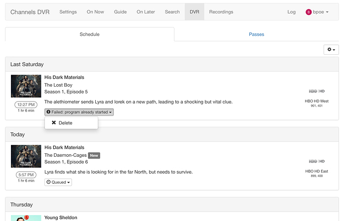

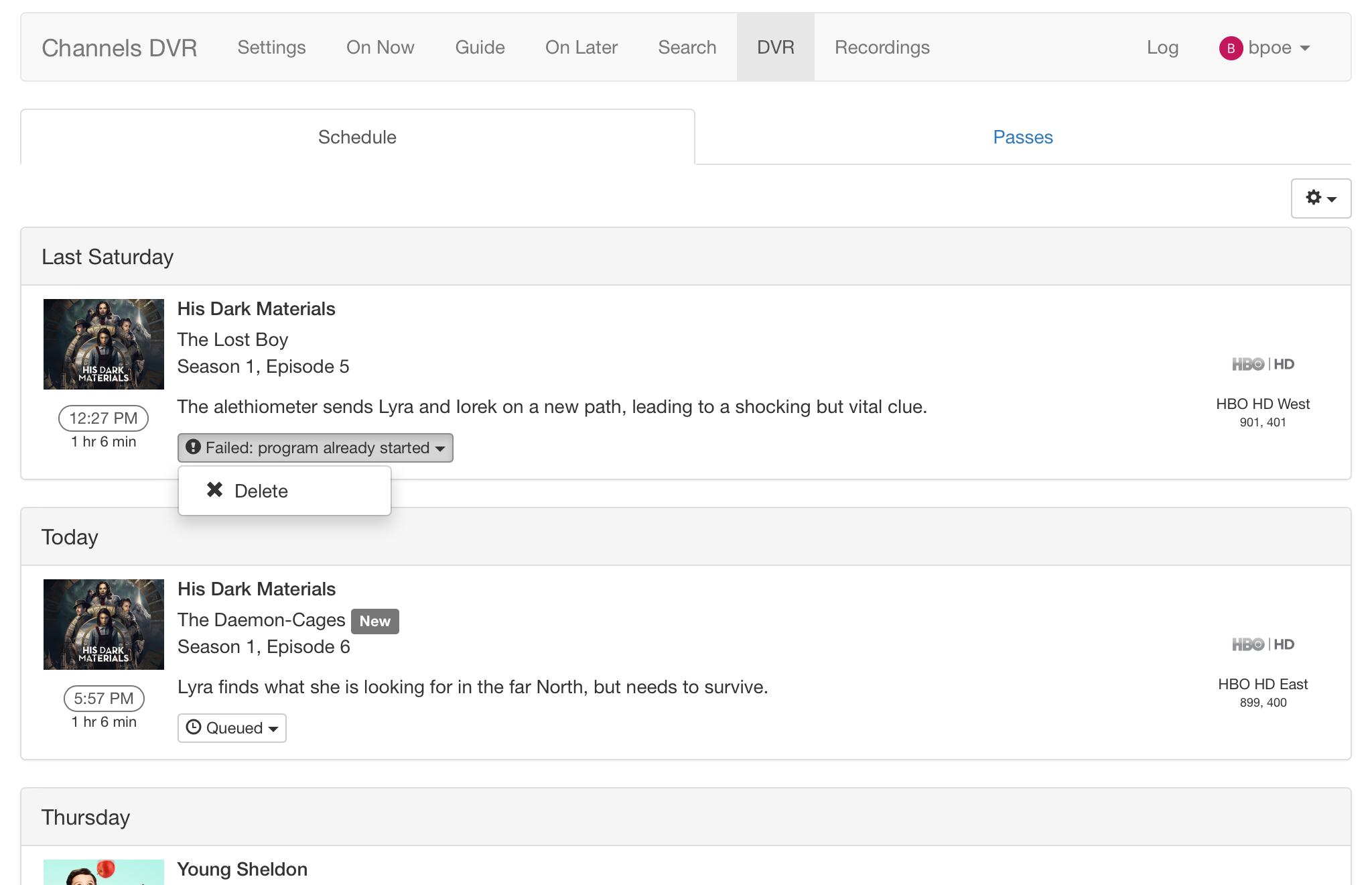

It looks like I’m in this same state with His Dark Materials right now. S01E05 was missed and I’m not even able to manually schedule it. So if there is anything you want me to collect or try out while I’m in this state, let me know.
Where are you trying to manually schedule and what happens when you try?
I’ve tried from the iPad app and the Apple TV app. I enable HTTP logging and I see this in the log:
[GIN] 2019/12/09 - 12:04:24 | 200 | 15.7068ms | 10.0.1.33 | PUT /dvr/jobs/1575750420-44
2019/12/09 12:04:24 [DVR] Waiting 5h52m35.1109084s until next job 1575943020-44 His Dark Materials
But when I go back to the scheduled recordings, it’s not listed.

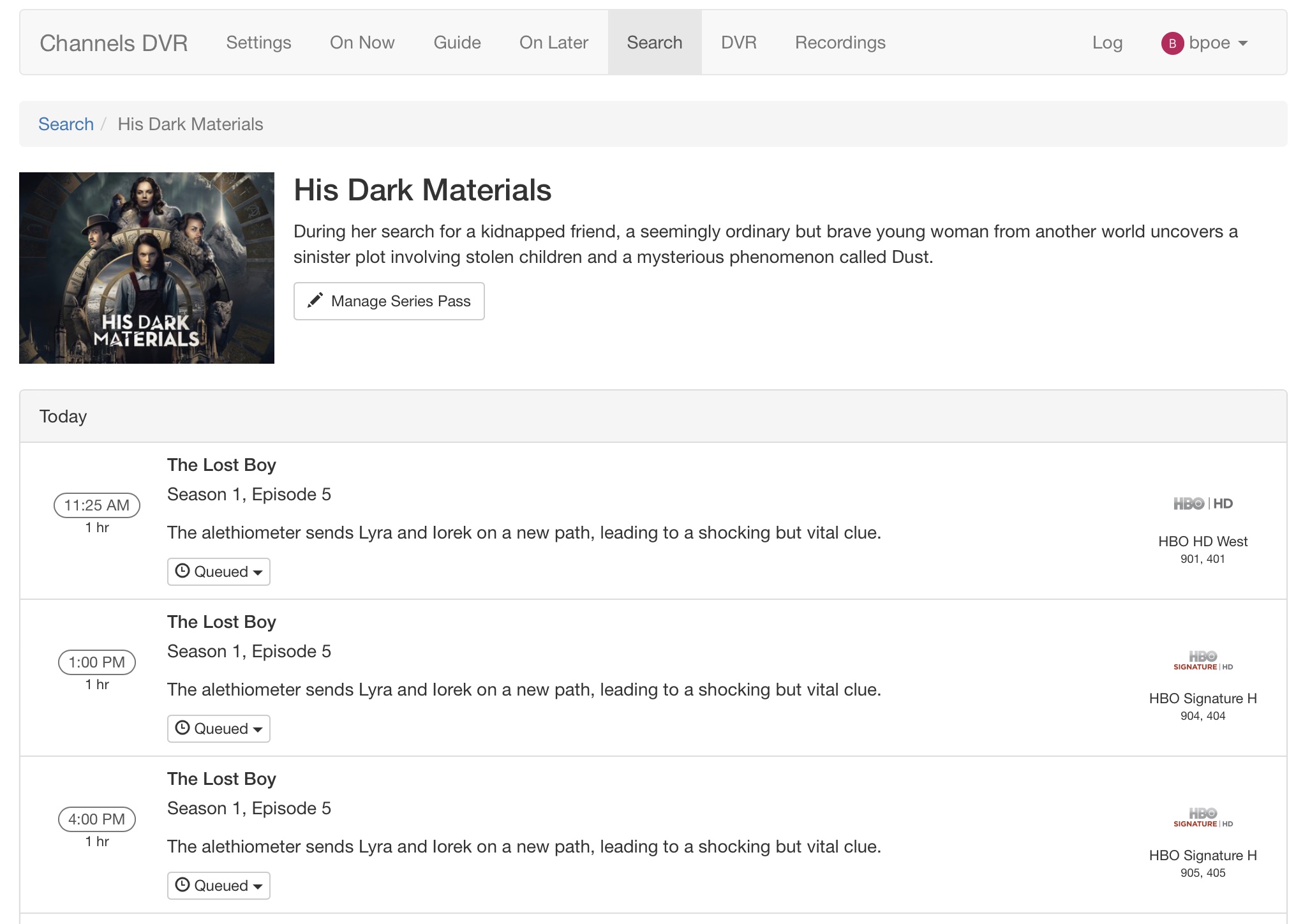

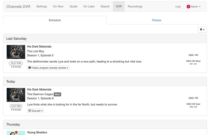

Can you try from the web UI
If I look at the upcoming episodes on the web UI, it says that it is queued
Does it show on the Schedule?
No. Only the failed attempt and the next episode.

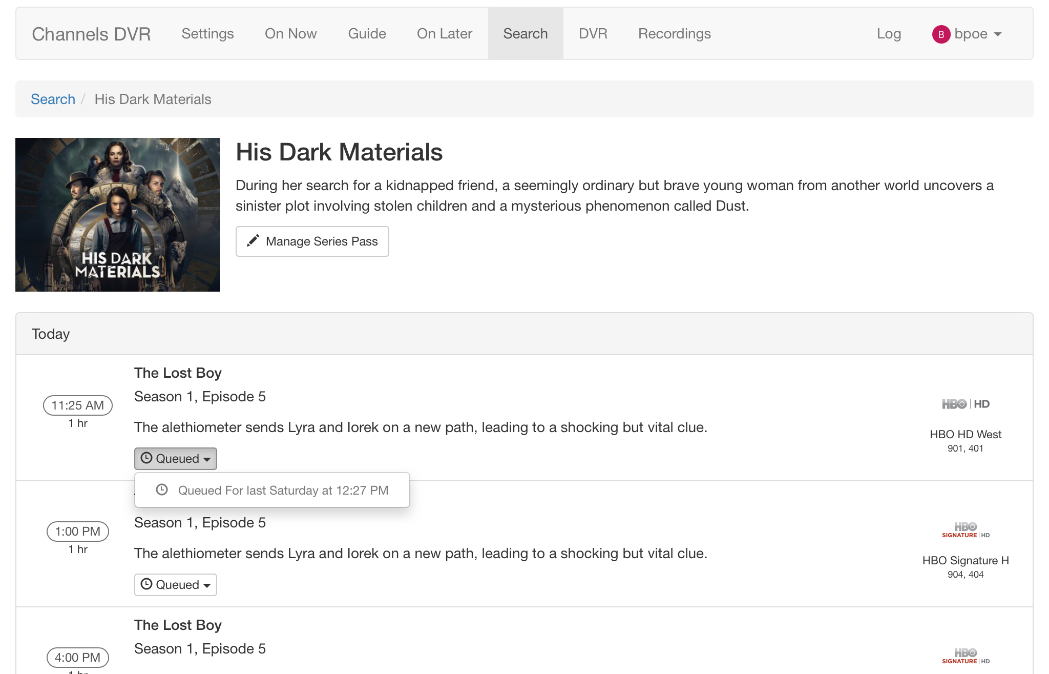

On the previous screen if you click the Queued drop down what does it say?
I’m not sure which screen you meant, so here is both
Okay I see what's going on. It thinks it's still scheduled in the past.

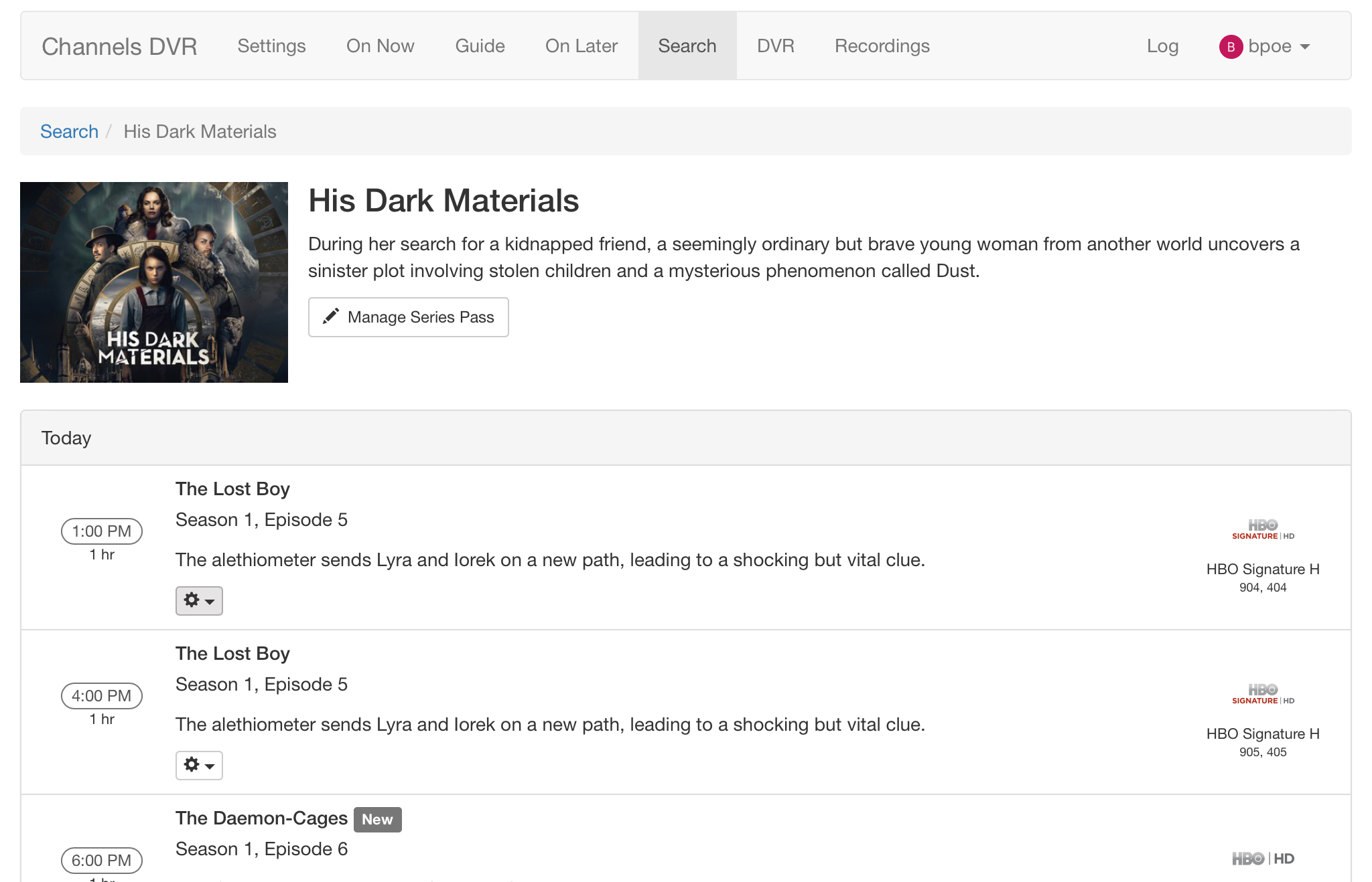

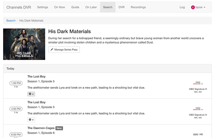

If you delete from the Schedule, does it then get rid of the Queued state in search?
Yep! I can try to manually schedule it again, but should I wait to see if the engine will pick it up?
Great. You can pause/resume the pass and it should reschedule.
I will fix the bug where it gets stuck as Queued after a failure.
Pause/Resume trigger the job to record the episode. Thanks for the help and thanks for looking into the bug! The awesome support from you guys always restores my faith :slight_smile:
Thanks for reporting this issue and for helping us narrow down the root cause.
The bug with the stuck Queued state has been fixed for the next DVR build.
