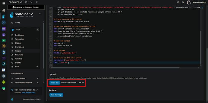

@chDVRuser If you're willing, here are a couple of updates to the image building process in post #1, that will yield a result even closer to "stock" (based on the recently posted fancybits Dockerfiles). This also works with YTTV, and it'd be interesting to know if it makes a difference with Xfinity.
A second bash script is needed, in addition to run.sh listed above. As always, when creating Linux scripts be sure your editor is using Linux-style linefeed line endings:
extract-version.sh:

And here's the Dockerfile, as closely matching the fancybits version as possible, while using Debian 12 and Chrome:
FROM debian:bookworm-slim
# Install dependencies
RUN apt-get update && \
    apt-get install -y --no-install-recommends \
        curl \
        gnupg \
        ca-certificates \
        tzdata \
        xvfb \
        tini && \
    rm -rf /var/lib/apt/lists/*
# Add Google Chrome APT repo and install Chrome Stable
RUN curl -fsSL https://dl.google.com/linux/linux_signing_key.pub | gpg --dearmor -o /usr/share/keyrings/google-chrome.gpg && \
    echo "deb [arch=amd64 signed-by=/usr/share/keyrings/google-chrome.gpg] http://dl.google.com/linux/chrome/deb/ stable main" > /etc/apt/sources.list.d/google-chrome.list && \
    apt-get update && \
    apt-get install -y --no-install-recommends google-chrome-stable && \
# Create necessary directories
RUN mkdir -p /channels-dvr/data /data
# Copy and execute version extraction script
ADD extract-version.sh /usr/local/bin
RUN chmod +x /usr/local/bin/extract-version.sh && \
    rm /usr/local/bin/extract-version.sh
# Copy run script
ADD run.sh .
RUN chmod +x run.sh
# Set volume
VOLUME ["/channels-dvr"]
# Set tini as the init system
ENTRYPOINT ["/usr/bin/tini", "--"]
CMD ["./run.sh"]
Before clicking build, be sure you attach both run.sh and extract-version.sh. Use the typical <Ctrl>-Left Click method for selecting additional files after clicking on the first. It should look like this:
Probably a bit of a longshot that it'll make a difference -- but, who knows?
