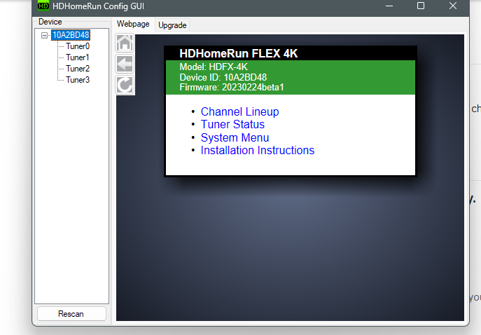

@troyboyjbl do you have the Model: HDHR5-4K ?
Wonder if any of the newer hdhr4k have this issue. Mine is a kickstarter unit
Yes that is my unit. 1 is a Kickstarter. The other I added later, both same model number.
Anyone with a HDFX-4K care to test all their atsc3 channels?
