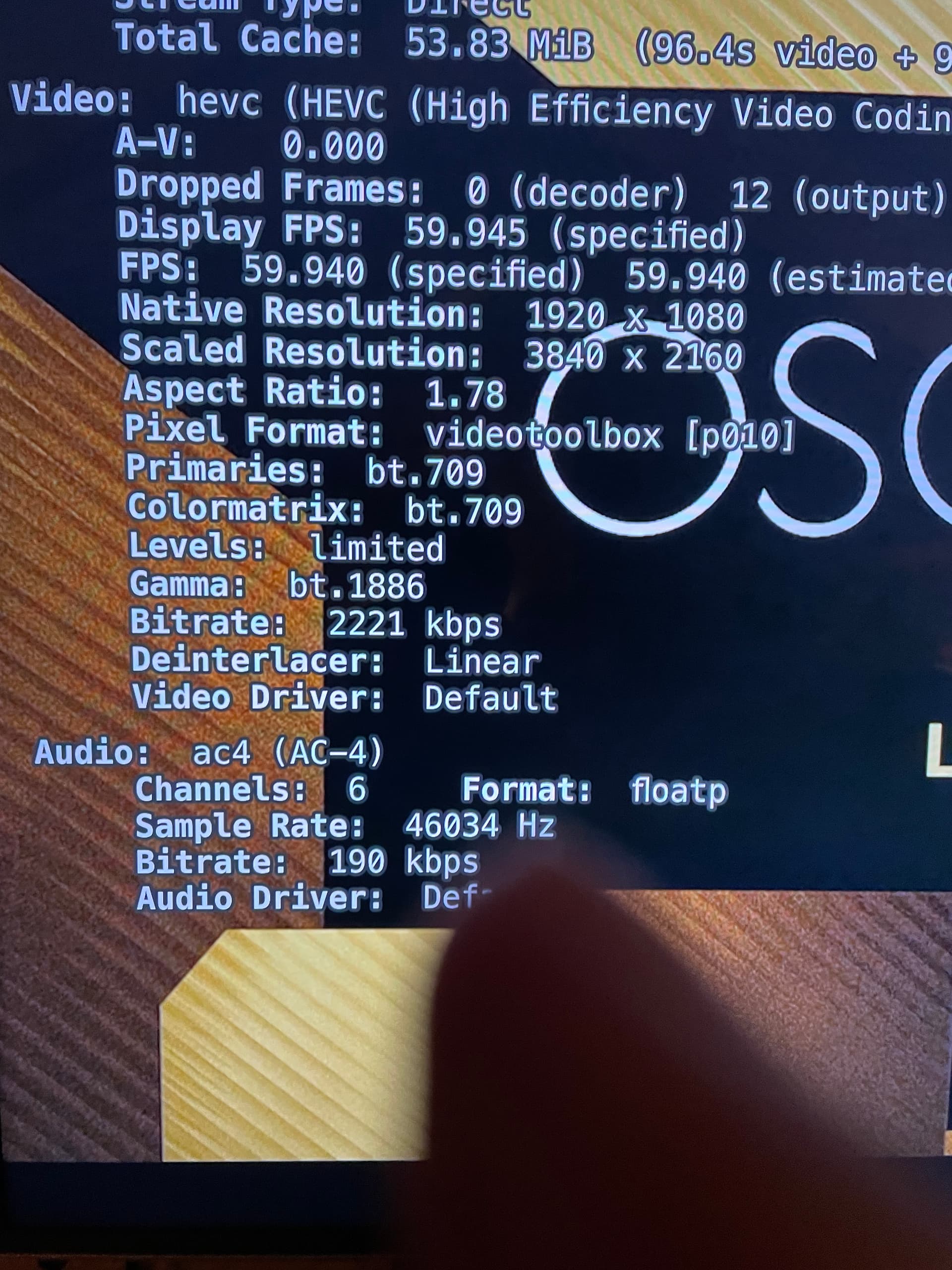

Yes - gigabit cat 6 to a Synology 218+ with 6 gigs of ram. It takes about 6 seconds to acquire a signal. It records fine, Sorry the picture is not the best - taken while watching the recording. The recording playback was immediate.
