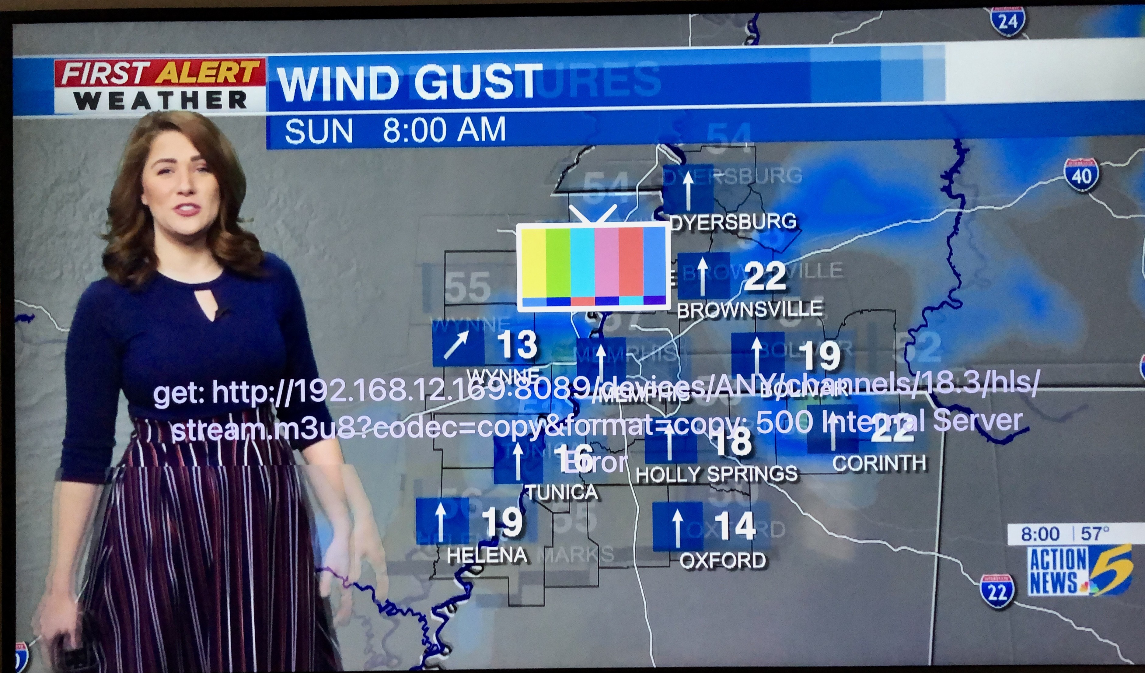

I get this error message whenever I try to view channel 18.3
You have an intermediate Channels DVR feeding that client, I suppose? The problem is the format=copy parameter. If you want to just transcode, but stream HLS, then you need to remove the format parameter. If you want the original MPEG-TS streams, you need to change how you retrieve the playlist from Channels, and use the /devices/ANY/channels.m3u?format=ts endpoint.
What do the logs on the DVR server at 192.168.12.169 say? What do the logs on the DVR server that Apple TV is connecting to say?
I am trying to tune the channel from the guide. The image of the weather person that is displayed is the channel that I’m trying to change from. I’m not sure what you mean by intermediate Channels DVR.

2021/11/21 17:39:14.804268 [ERR] Could not start stream for 1072A35B ch18.3 WDNM-LD: HDHomeRun: 801 Unknown Channel
The HDHomeRun is currently not able to see the 18.3 station. You may need to adjust your OTA antenna and rescan to fix this.
