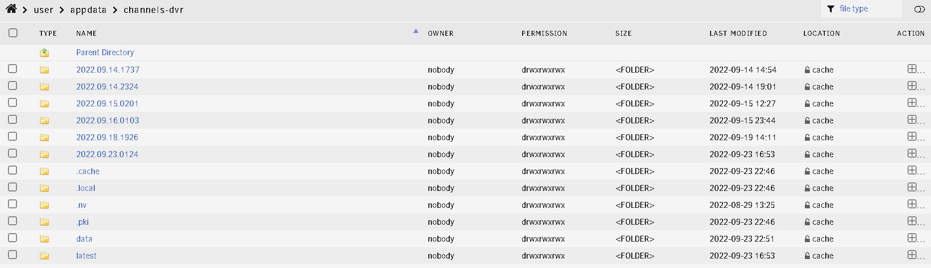

Can you check the ‘/mnt/user/appdata/channels-dvr’ folder and see if the owner is set to nobody:user for the folder and all the files?
Looks like everything is owned by "nobody". I suppose worse case I could just blow away the config folder and restore from backup.
