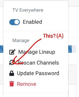

Still working. I just use the Manage Line Up Rescan Option in Sources.

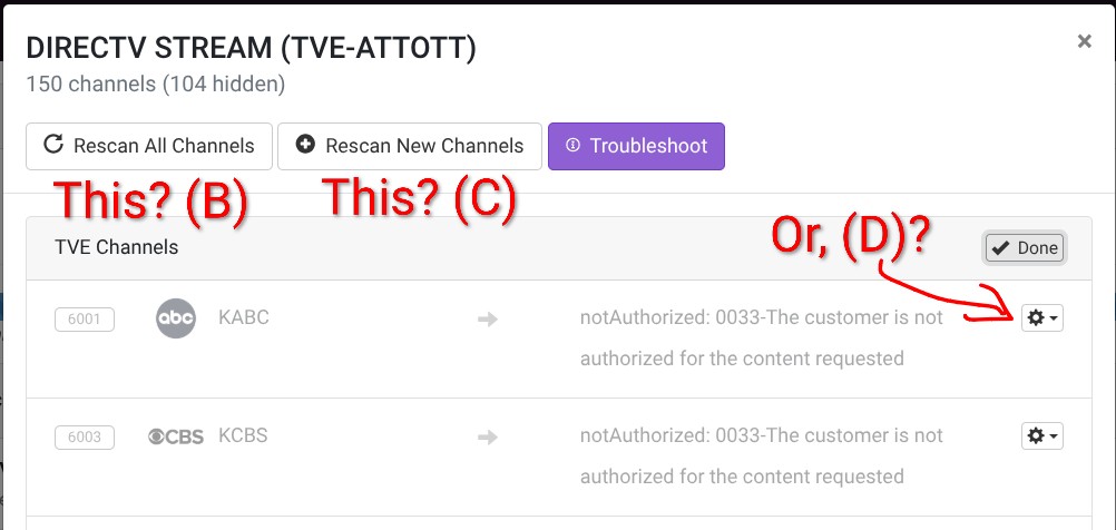

I aplologize that I'm a little slow in understanding. Can you please clarify?
Screenshot 2025-09-08 6.28.05 PM
D
There are a lot of options but D is what I use. Forum made me type
Thank you. :slightly_smiling_face:

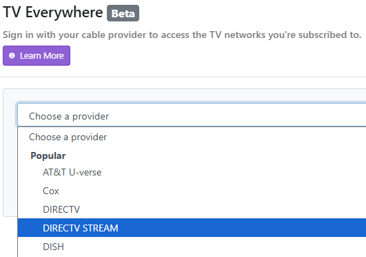

Have you tried both the DirecTV and DirecTV Stream as your source? Some of us had luck with one or the other at times.

Did you remove the source or just rescan the individual channels that weren’t working?
Before removing a Directv Stream source, try adding Directv as a source (or vice versa). That will tell you if the servers are working correctly. If they are working correctly, then just rescan the missing channels- see post about 4-5 above.
What I have been seeing is that I normally lose FS1 & BTN but all others work fine. So I just rescan those in the Source to see if they come back.

After it completes go into the source and scan individual channels.
