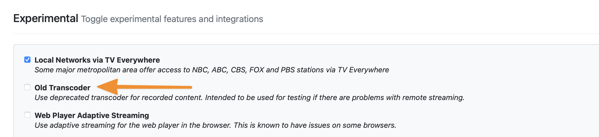

Please login to your DVR Web Interface and disable the experimental setting Old Transcoder:
That was only on as a test. It wasn’t working without (or with) that setting on. I’ve turned it off and tried streaming and submitted diagnostics again.
