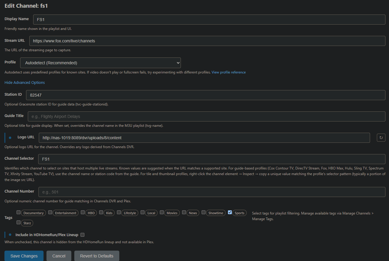

Channels tab
Manage Channels dropdown
Add Channel
Select source button (Fox One)
Fill out the form

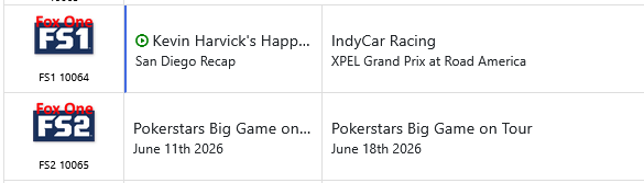

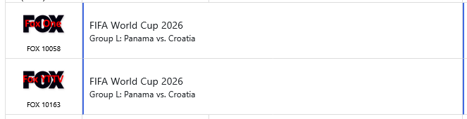

I have channels on both Fox One and tv.YT setup
Screenshot 2026-06-23 at 16-53-43 Channels Guide
Screenshot 2026-06-23 at 16-56-20 Channels Guide
So that's a manual override to the stock Prismcast settings? Is that something that I have to maintain over time, or does it never change with Prismcast updates?
No, it's simply adding a channel using the built in service Fox One and the Autodetect profile.
Once you get down to Channel Selector on the form, it's a popup listing available channels.

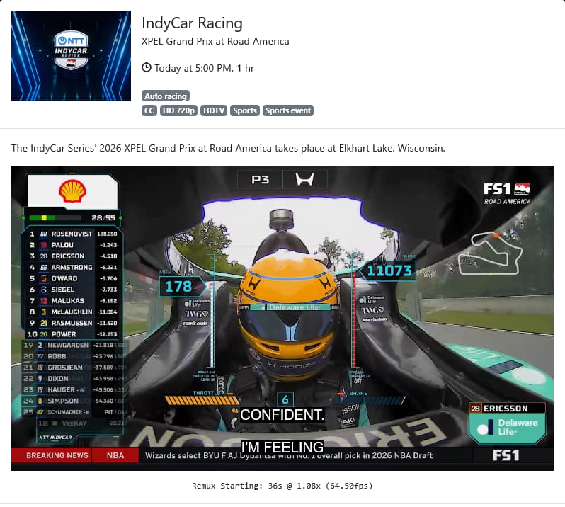

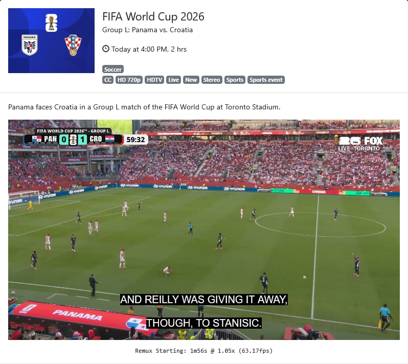

I'll have to check that out once I've upgraded my server (again). The Windows system I have now produces choppy video that is virtually unwatchable with Prismcast. Do you have a screenshot with what the closed captions looks like?
Shouldn't be an issue using direct TVE from the networks
Depends on what's displaying it. It's regular closed captions.
Here's the web UI player on a couple
