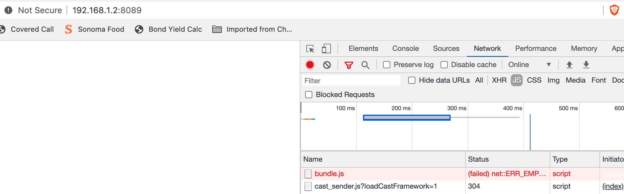

Second time this "blank 8089 screen" has happened to me. My set up is Synology NAS and Synology SRM (router). Check to ensure both my firewall on my NAS was DISABLED and port 8089 is open via uPNP. Last time this happened, I rebooted my NAS (not my router) and everything was back to normal. So off to chrome inspector, bundle.js:1 Failed to load resource: net::ERR_INCOMPLETE_CHUNKED_ENCODING off to https://stackoverflow.com/questions/23217824/neterr-incomplete-chunked-encoding. Removed the cookie/cached data in both my chrome browser as well as Safari, both are not loading the page. Thoughts on how to figure out what is going on?
The error is ERR_EMPTY_RESPONSE above
