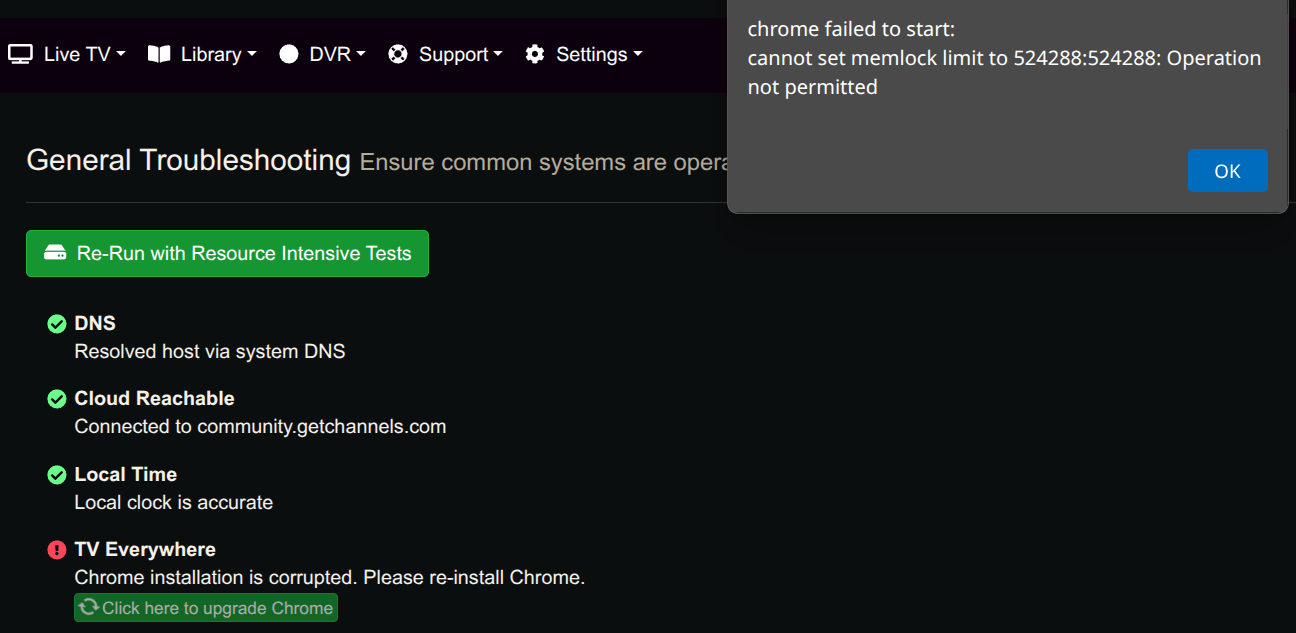

When attempting to add Philo or Sling TV sources I get the error message
" chrome failed to start: cannot set memlock limit to 524288:524288: Operation not permitted"
I tried rebooting my server to no effect.
Version 2025.07.20.0706
Kubuntu 24.04
Kubuntu 24.04
Did you install google chrome and or update it to the latest version? In troubleshooting what version of chrome are you on?
It is a problem with Chrome. Troubleshooting revealed
"Chrome installation is corrupted. Please re-install Chrome."
Using the Upgrade Chrome link that appeared with the error message produces the same error message.
I used apt remove google-chrome-stable and apt install google-chrome-stable.
Then troubleshooting produced no errors. So I tried again to add Philo and the original error message appeared. After that I ran troubleshooting again and it once again complained about Chrome being corrupted.
So the original problem returned.
