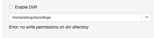

Hi. I'm troubleshooting why recordings aren't happening and I decided to restart the DVR services. However, when I try to re-enable, it's telling me: " Error: no write permissions on dvr directory".
37%20AM
My recordings directory is NFS mounted to a QNAP NAS and I gave it write permissions from my channels VM. Both the channels-dvr and recordings folders are installed/mounted on my home directory. I am able to go into the recordings directory and create a file, verifying that my user ID has write permissions. The logs don't say anything.
