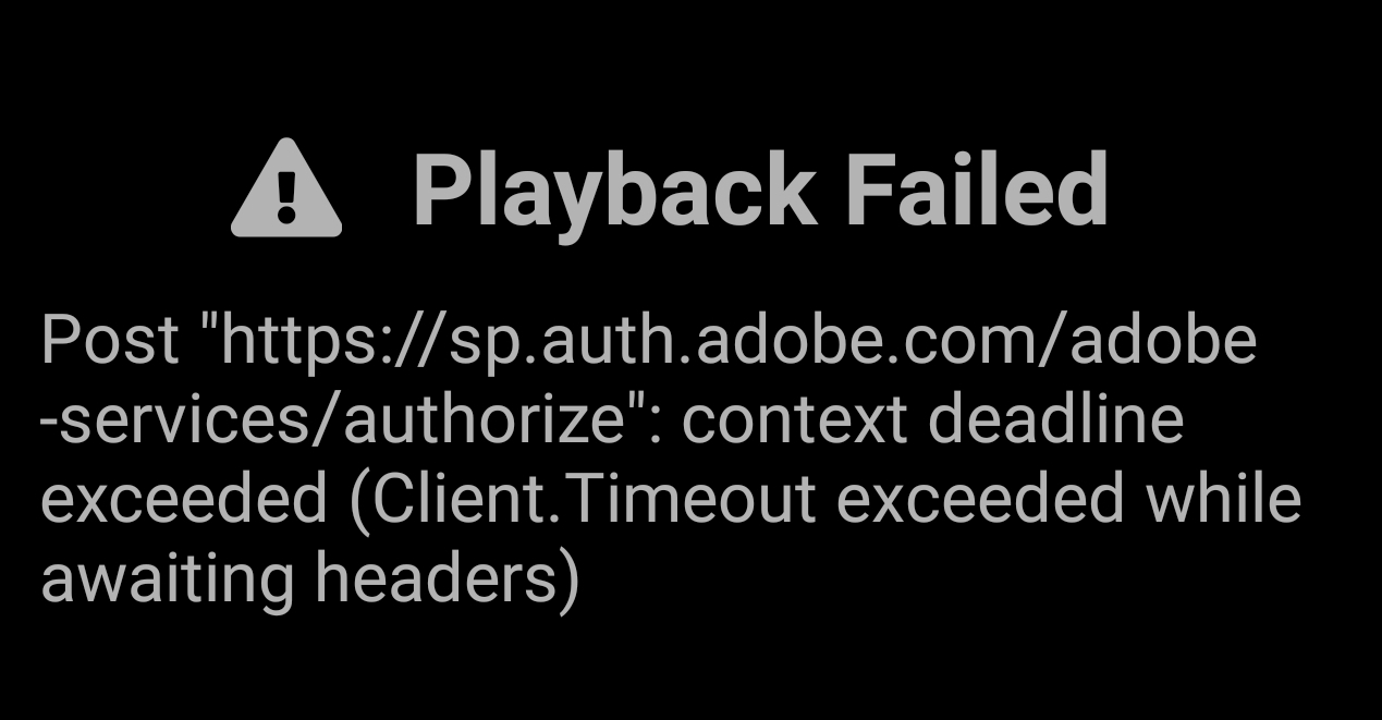

Can't playback any TVE channels
Having trouble streaming any TVE channel.

I'm also on Spectrum. I can only stream ESPN, NBCSN, and Fox Deportes. All other channels give me the above error.
Yeah I’m guessing it’s a spectrum issue right now. I feel like I get these errors every so often but tonight it was very widespread.
The fact that when I moved to my other provider ( I have both my parents and my provider logged in) and it worked totally fine - makes me believe spectrum is having issues. At least I know now it wasn’t just me having the issues….
same here. also Spectrum.
I also had a failed recording via spectrum TVE yesterday. Found another airing just after midnight eastern and queued it up. It recorded just fine, so at least for me whatever the issue they were having, they seem to have resolved it.
Yup seems like it was back to normal this morning.
Seems to have come back again. Same error.
Same for me with Fear the Walking Dead. Also TLC started late due to error, but they cleared after 4 or 5 tries.
20:59:11.694008 [ERR] Failed to start stream on channel 6086 via TVE-Spectrum: TVE: Post "https://sp.auth.adobe.com/adobe-services/authorize": context deadline exceeded (Client.Timeout exceeded while awaiting headers)
2021/11/28 20:59:11.711067 [DVR] Error running job 1638151140-3 Fear the Walking Dead: could not start stream on channels=[6086]: TVE: Post "https://sp.auth.adobe.com/adobe-services/authorize": context deadline exceeded (Client.Timeout exceeded while awaiting headers)
Same here. Looks like TVE Spectrum is failing authentication across most channels.
