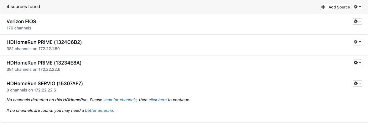

Can't remove source
Added the wrong source, it will not go away, it gives enough of a response to channels DVR server to keep it around.
just keep getting this filling my logs,
2022/11/27 13:18:19.072865 [ERR] Failed to parse HDHR #15307AF7 lineup: invalid character '<' looking for beginning of value
2022/11/27 13:19:21.973816 [ERR] Failed to parse HDHR #15307AF7 lineup: invalid character '<' looking for beginning of value
2022/11/27 13:19:25.212133 [ERR] Failed to parse HDHR #15307AF7 lineup: invalid character '<' looking for beginning of value
if i unplug it and restart channels-dvr service, its gone but comes back once the device is back on my network. It's actually a SiliconDust ServIO unit

If you added it by IP address, it can also be removed using curl
Screenshot 2022-11-27 at 11-51-08 Channels Settings
Replace 127.0.0.1:8089 with your Channels DVR Server IP address and port
curl -XDELETE http://127.0.0.1:8089/devices?ip=172.22.22.5
This will forget the manually entered IP.
Verify by checking that http://127.0.0.1:8089/settings no longer contains
"device.manual.172.22.22.5":"true"
Then restart Channels DVR
So it wouldn't let me set provider at all, but, the curl -XDELETE*172.22.22.5 command worked, it disappeared from settings and admin/settings in a normal browser after restarting the channels service.
