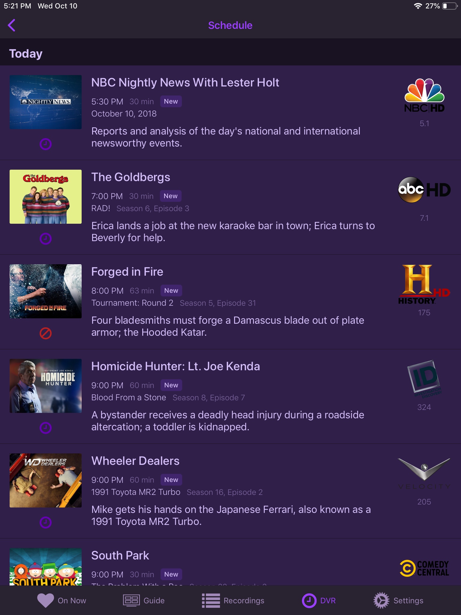

So today I realize I'm going to run into a tuner amount issues. So I decided to cancel Forged in Fire at 8p in advance and record the later 11 o'clock show.
But I can't record the 11 o'clock show. The app goes through the motions iPhone and Apple TV, but none of them end up scheduling 11 o'clock show.
fullsizeoutput_cc fullsizeoutput_cd fullsizeoutput_ce
