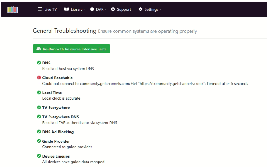

I won't be able to check to see if I can actually submit diagnostics until I get home where my client is, but I expect it to work now since "Troubleshooting" in CDVR is now all green where before it had a red X.
Never mind, it's not working, seems it was not the OAuth service. Seems to be random on whether or not it will be Cloud Reachable. I can refresh the Troubleshooting page and about 50% of the time it's reachable, and the other 50% it is not. Hmmm......
Recommend changing your dns server on your synology to quad 9. settings should be in with your static ip settings. You may have to disable ipv6 as well.
Thank you for this! Quad9 seems to have done the trick!
