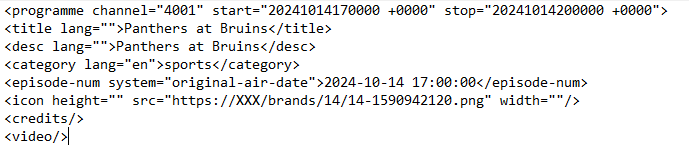

Are category filters case sensitive? As example, the built in Channel Collections for Sports doesn't seem to grab my providers channels for sports. I suspect it's because sports is case sensitive?
as example XML data:
Panthers at Bruins Panthers at Bruins sports 2024-10-14 17:00:00

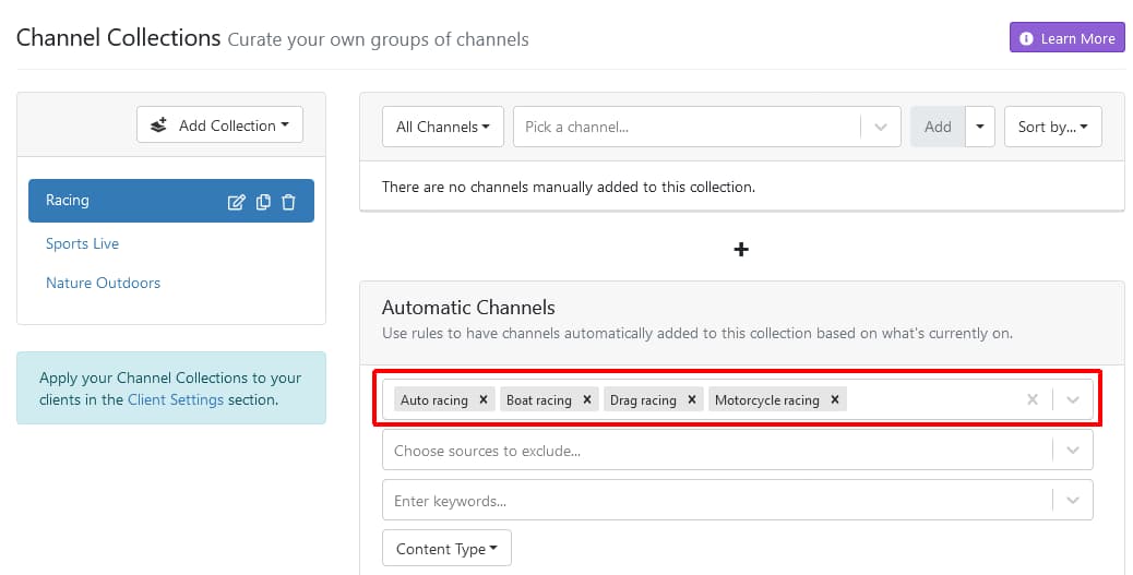

You can add multiple Genres to Channel Collections using the Automatic Channels section
Got it. Doesn’t look like it’ll let me add “sports” (all lower case) and “Sports”
I have somewhat of a unique set up as I pull most of my channel data from gracenotes built-in And some channels from threadfin. Threadfin won’t uppercase the S. So basically, it leads me to Missing some sports unless I view all channels.
Hey developers anyway to get around this case sensitive problem?
Yah, unfortunately Sports is a Category, not a Genre.
The guide data would have to include the category Sports.
<category>Sports</category>
Do you have an example of the raw xml for a game?
You're right. That's not going to work.
All Categories and Genres need to have their first letter capitalized.

Short term “fix” I found is create a channel collection with sports (all lower case) then made a sports2 with the uppercase S. Kinda lame but it’ll work for now.
