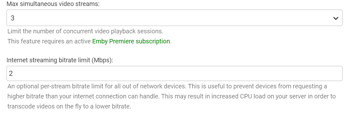

I really like the way EMBY handles remote streams ... you can set max streams and maximum bitrate...
