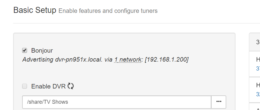

Changed DVR Recording Directory but now Enable DVR is stuck spinning
On my QNAP, I changed the DVR recording directory in settings but now Enable DVR is stuck spinning. How can I get the DVR to run again with the new directory?

When I left-click on the Channels app, it opens the setup page. When I right-click, I get the attached screen shot that only allows to 2 options:
Channels%20DVR%20app%20menu
Is there another place I'm missing?
