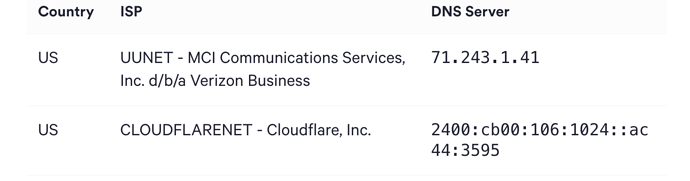

Which DNS server are you using? Have you had any problems resolving any other addresses?
Some details and steps you have taken would be helpful.
Thanks for trying to help.
I haven't encountered a problem before that I know of or have identified as a DNS issue so I'm trying to be methodical in my steps to resolve.
I have cleared the caches of all my browsers (Google/Safari/Firefox/Arc) -- rebooted my router (an Orbi system that is attached to a very old Verizon modem - could that be part of the problem?) -- started Mac in safe mode -- and tried connecting with my iPad pro's browser. Have I been taking the proper steps?
The best practice (for Channels) is generally to use the ISP-provided DNS servers. Your browsers and other devices won't have any relevance here, just your router and the machine the DVR server runs on.
After changing your DNS server, reset the DVR's connection to ensure it is picking up the proper DNS server from your router. Then from the DVR web UI try to re-download the guide: Settings > Live TV & DVR > Guide Data > Maintenance > Delete and Recreate Database.
If you continue to have issues, check the logs to see what the server is reporting as a problem.

DNS problems
Since I'm a newbie at this I'm not sure how to solve it. Suggestions?
Check the dns network settings on your NAS
Thanks for the direction - since I’m still new at some of this I’ll have to do some research but I can say that a guide did download finally yesterday so I can use the app right now. Don’t know how that happened with the errors still showing but I’ll take it and be thankful!
