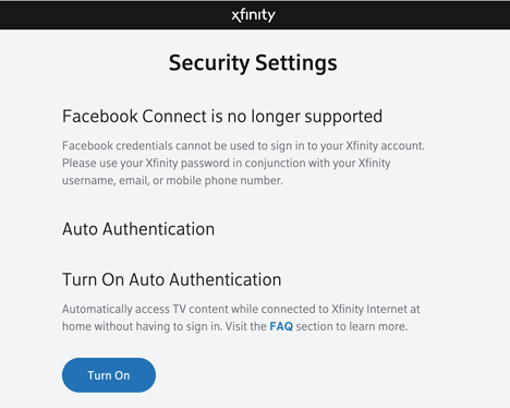

I don't see an option on xfinity to change away from auto-authentication. And, I've never had to worry about it before. Did Xfinity change something, or am I the only one having the problem? I tried created a new account as well, same issue.
Edit: I found a place to turn auto-auth on, but it's not turned on.

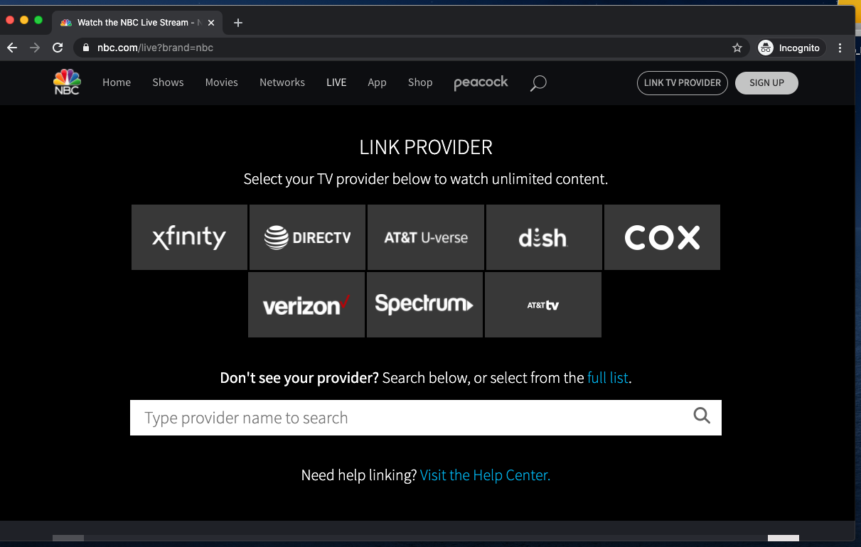

If you go to nbc.com/live in chrome incognito and click Xfinity, does it show a login form?

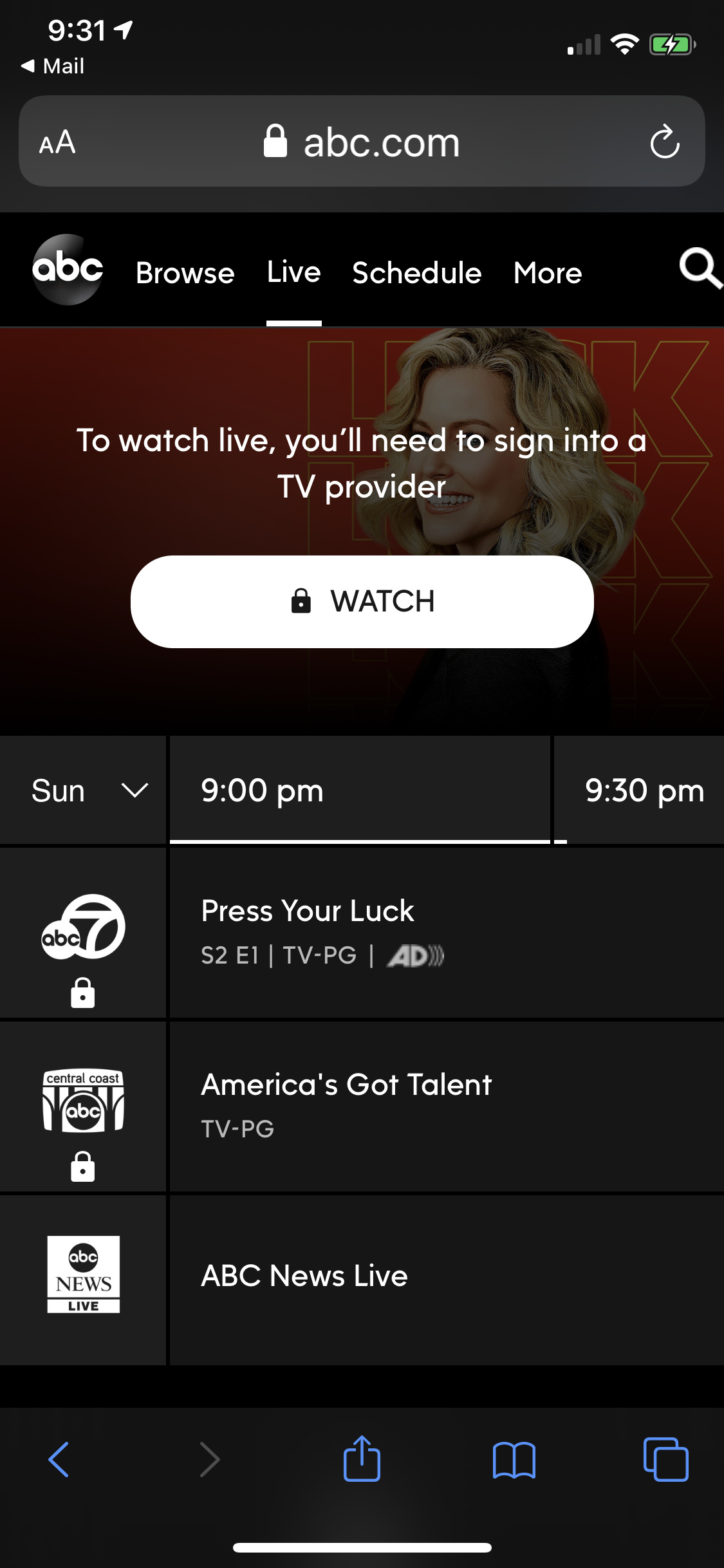

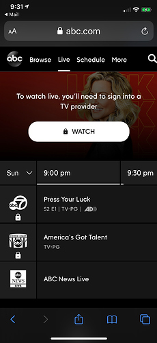

The NBC site tells me to download the nbc all (on phone now), but there is a link to sign in. This is what the abc live site shows.

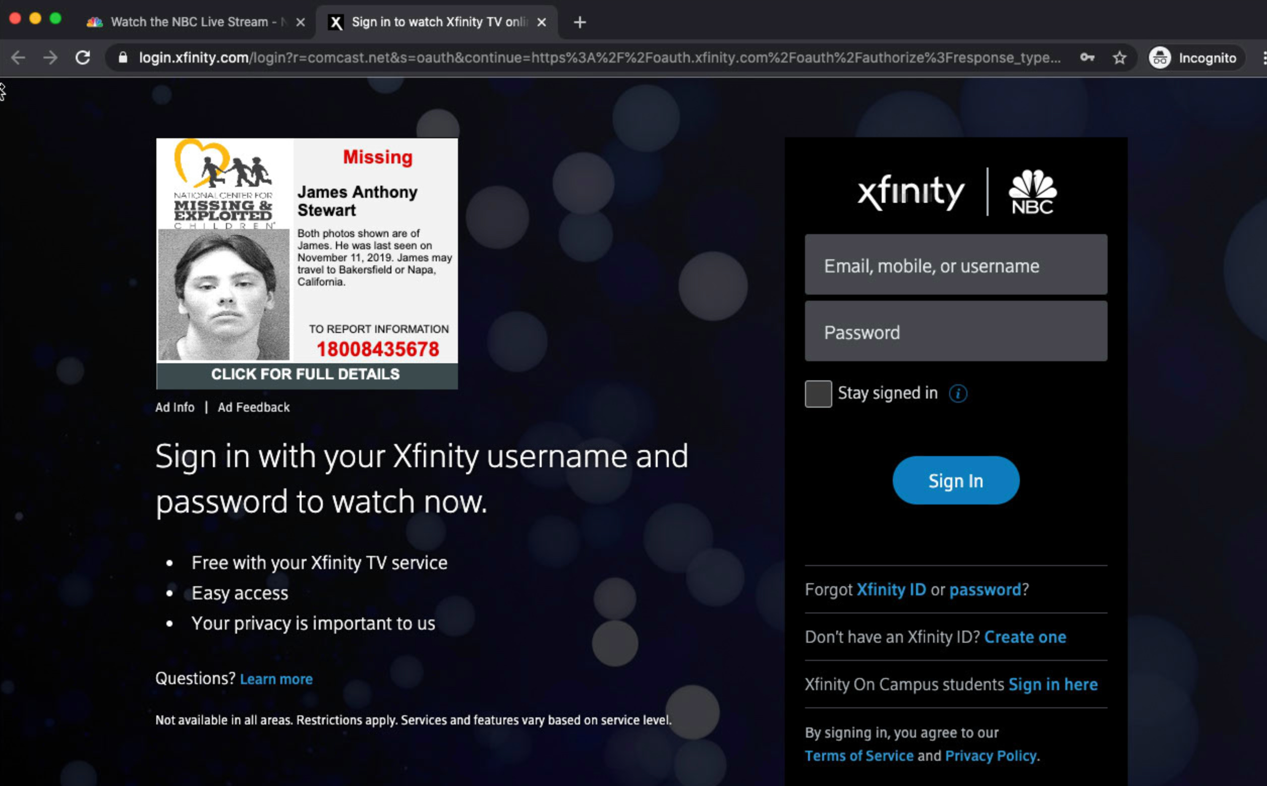

Please try in chrome incognito on the Mac running your dvr
Click Xfinity does it show a login form asking for your login
Any idea on what I can try next? I talked to xfinity, but they say it’s working fine, since I can log in via the TVE websites.
