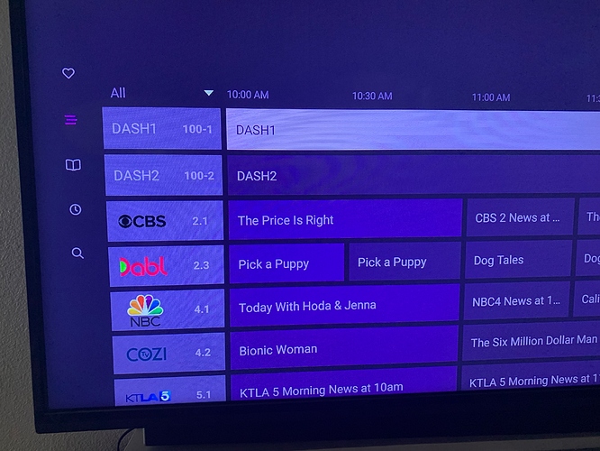

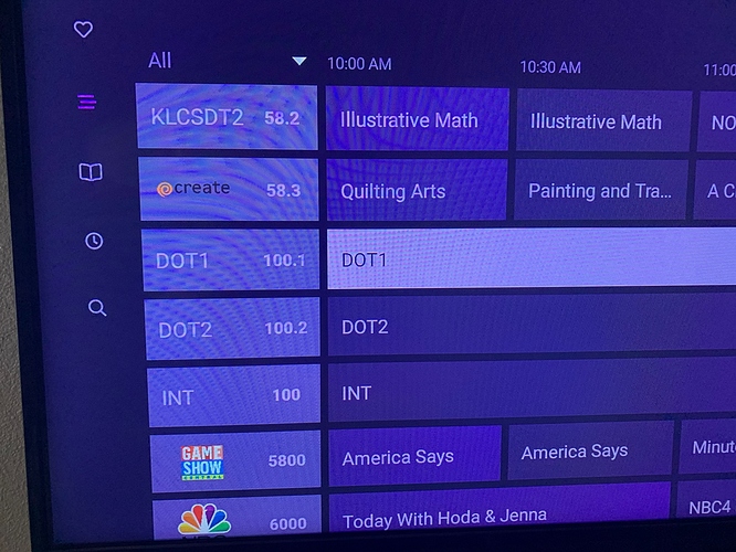

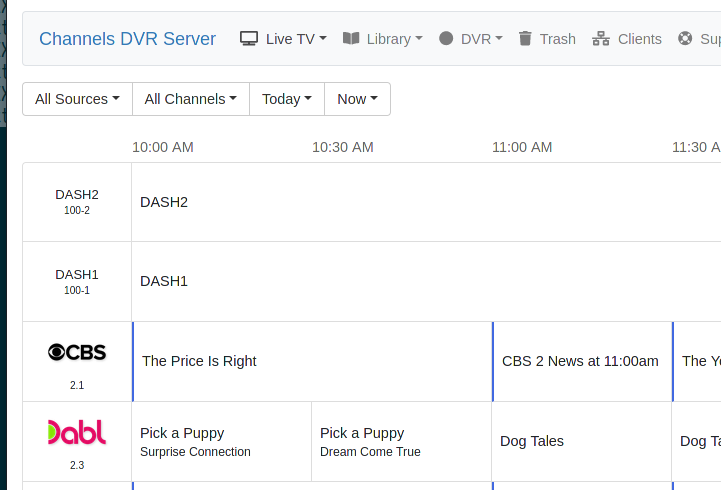

Here are some examples:
I created a brief playlist with the following lineup:
  • 100 INT
  • 100-1 DASH1
  • 100-2 DASH2
  • 100.1 DOT1
  • 100.2 DOT2
Logically, that is how I would expect the channels to be sorted. However, that is not the result I get.
DVR:
web2
Android:
Apple:
Source playlist:

Dashed numbers are not something we ever saw coming from HDHR, so it's not currently supported.
The bug on Android where dotted and non-dotted channels were sorted incorrectly is fixed in the next beta.
Thanks, Aman. Understandable about dash-notation for channels. Coming from Tvheadend, dash and dot were treated interchangeably; also, many TVs seem to prefer dash-notation for sub-channels.
With Android sorting fixed, the channel scheme can be changed to all dot-notation.
