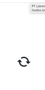

I just tried to access the admin interface for the DVR and just get this spinning arrow.
image (Note ignore the text at the top of the capture. That was from a mouse hover over a bookmark link)
Any ideas on how to get the interface to load? The DVR appears to be working fine and I can access it from the app. I tried rebooting the QNAP NAS it is running on and that didn't fix it. I've also tried accessing IPaddress:8089/admin/ from multiple different browsers and that didn't work either.

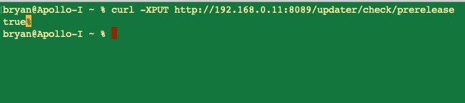

curl -XPUT http://192.168.0.11:8089/updater/check/prerelease

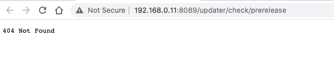

It gives a 404 error.
You need to run that command not click the link.
It should load now.
It did. Thank you.
