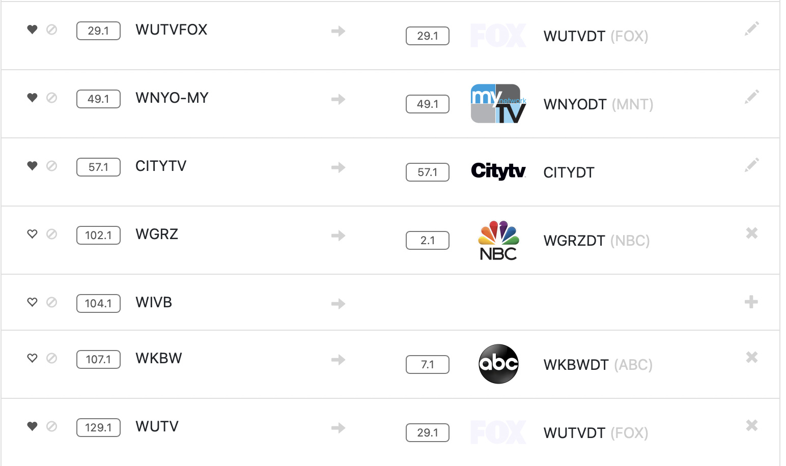

I have an HDHomeRun Connect 4K.
I'm located in Toronto, Ontario but since March I am now picking up several Buffalo stations' new ATSC 3.0 broadcasts.
The Channels lineup setting shows the ATSC 3.0 channel mapping on to the ATSC 1.0 channel number (for example WUTV at 129.1 > 29.1). But when I tune Channels to 29.1, it picks the broadcast on 29.1 and not 129.1. How can I fix this?

You would need to update the DVR server to prerelease for remote ATSC3 fixes.
That did it, thank you!
