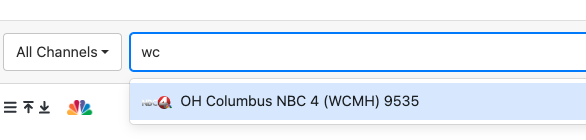

I have a single IPTV source that has been rock solid for quite some time. Recently, I've noticed a few channels (including our local stations) have dissapeared from my channels list. Other stations in the Channels app are working perfectly fine.
I have confirmed that my IPTV source still has the channels available and can stream directly from them.

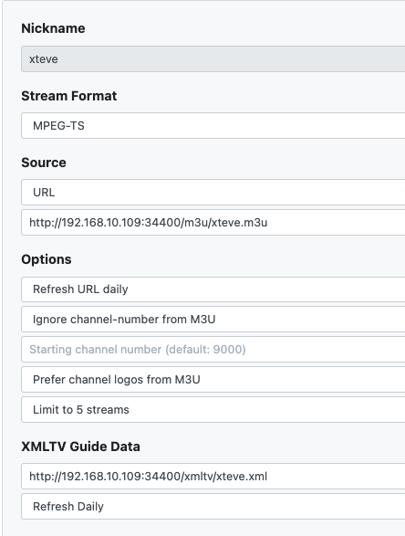

I use xteve and also confirmed that my m3u list contains the channels that is missing from the Channels app (example below). I have refreshed everything on the xteve side and also manually updated channels/guide data (redownloaded entire guide and also fetch guide updates).
Does anyone have advice for how I can get Channels to pull in all of the channels listed in my m3u?

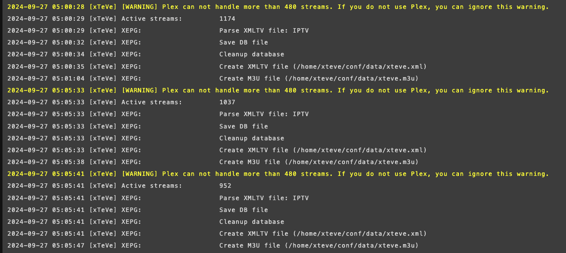

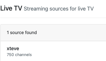

For context, my Channels found 750 channels from my xteve m3u:
In xteve, there were 1174 channels. I deleted a few groups from my filter in xteve to reduce the number of channels in my xml list. This dropped the xml by over 200 channels (1174 --> 952).

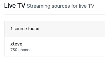

When I go back into Channels and redownload the XMLTV, it STILL only shows 750 channels. I'm not sure what I'm doing wrong here, but I hope it's something stupid and simple. :slight_smile:
Ooook... it was something simple and stupid!
I started searching to see if Channels had an upper limit of channels per m3u - and it DOES! Probably common knowledge for most folks. You can have a max of 750 channels per m3u list. When I removed some additional channels in xteve and reloaded the xml in channels, the # of channels matched and then my missing 'test' channel appeared.
