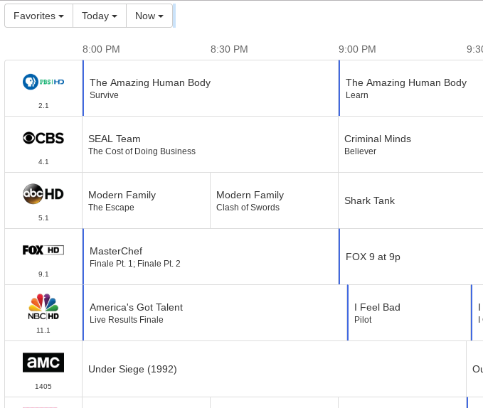

I’m not sure why - but starting sometime Sunday or Monday, my AMC guide data appears to be Western when I’m in the Eastern Timezone. This has caused my AMC recordings to be incorrect. I first noticed it last night when trying to play back Monday’s recording of Better Call Saul. What is interesting is when I tune in via the HDHomeRun App - the guide data is correct. I’m running the latest Beta 2018.09.19.0236 and have tried clicking the update/refresh button on my tuners several times.

The guide on the HDHomeRun Shows the correct shows, but AMC is not correct on my Channels guide for some reason. Channels thinks Under Siege is on:

Now that I’m looking at it several other channels are incorrect as well:
TBS, TNT, Lifetime, Nat Geo, BET, Cartoon Network are not showing correct guide data
It sounds like SiliconDust is sending you the PST versions of those channels instead of EST. This can happen if you’re using a VPN. You can either contact them with your device ID to tell them to fix it (and send you EST feeds), or switch your guide data to PST mode using Help With Understanding HDHomerun Premium Channel TZ Alignment in Channels DVR
