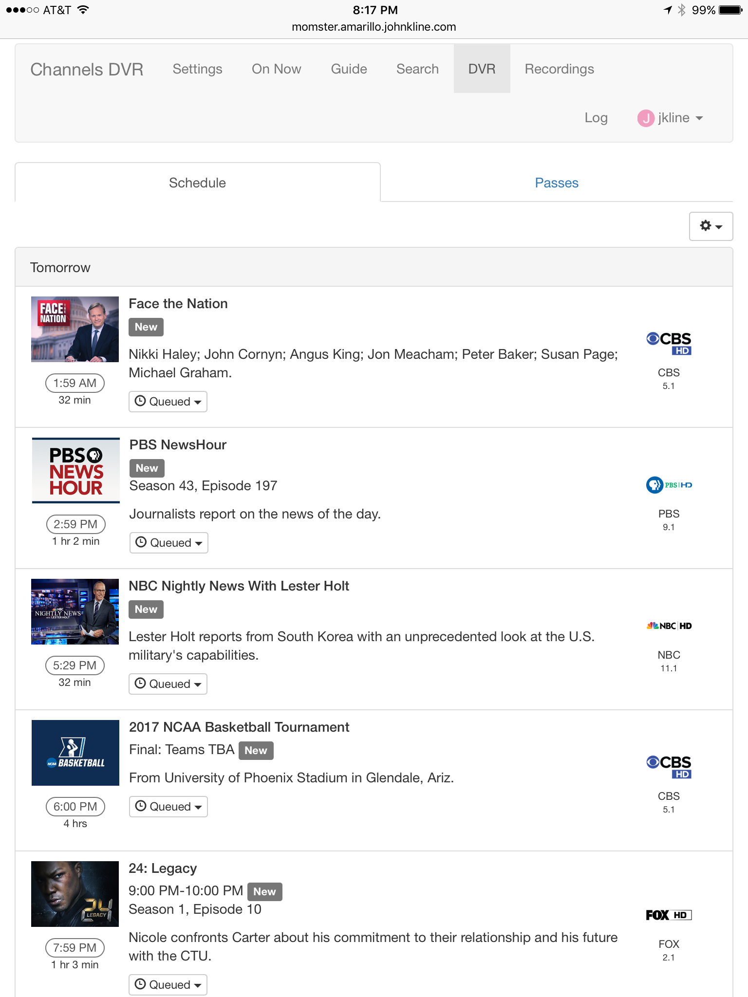

One more thing, KPIX here in SF often cuts Face the Nation short and plays the rest of it at 2AM Monday.
As you can see in the image below, another 1/2 hour of Face the Nation is airing a little less than six hours from now. Tonight's airing is also marked NEW. Could it be both airings have the same ID and that is causing the first airing to be deleted by Channels DVR?
Sounds like some sort of guide issue…
The job was initially queued, but then removed because the guide data updated and the airing was no longer match any passes (either it disappeared, or was no longer marked as New).
The original airing and re-airing DO have the same ID, but that’s normal and expected. In fact, that’s why the DVR decided to record the second airing. Usually it ignores the second airing, because it already has a recording with that episode ID.

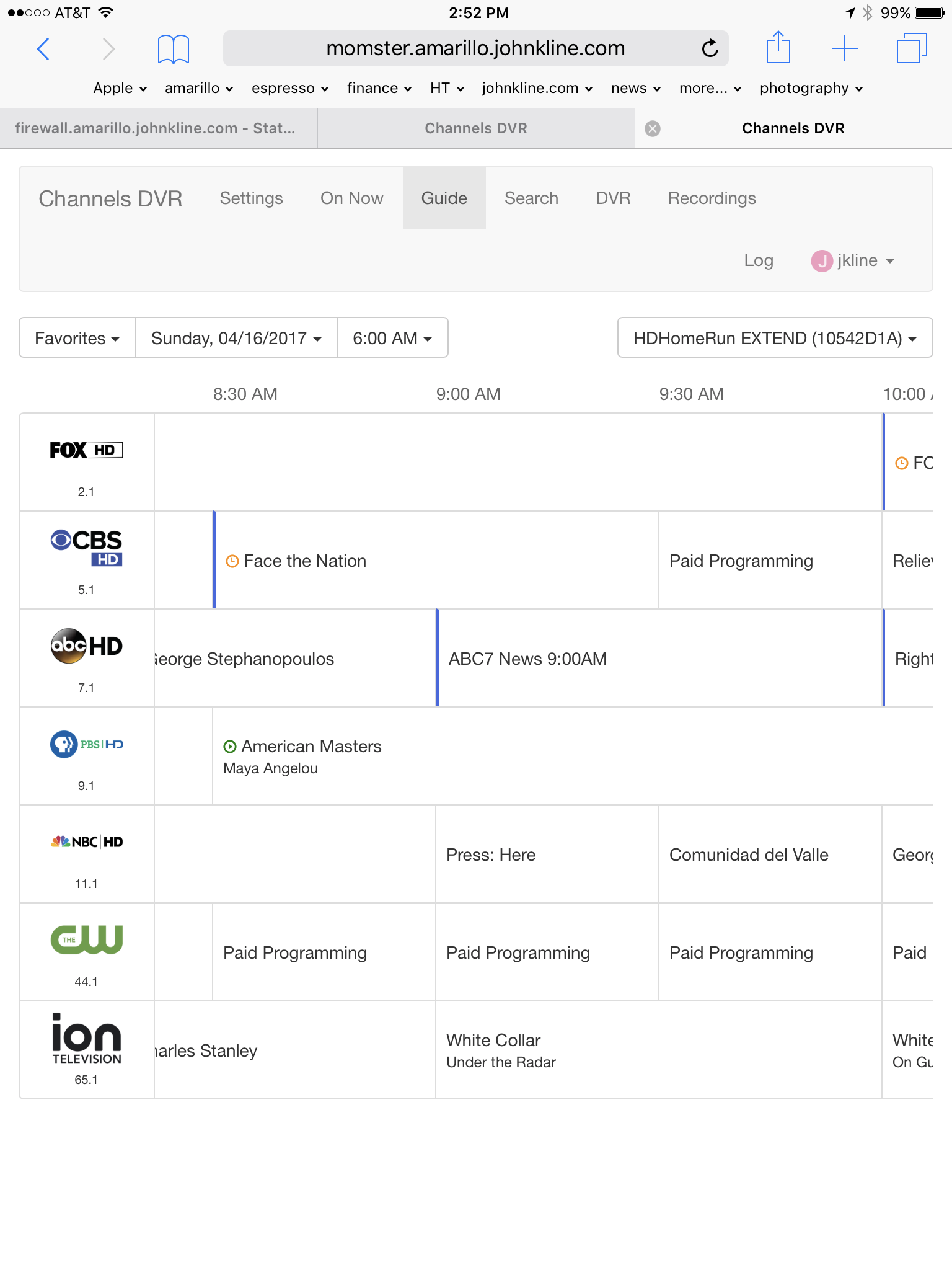

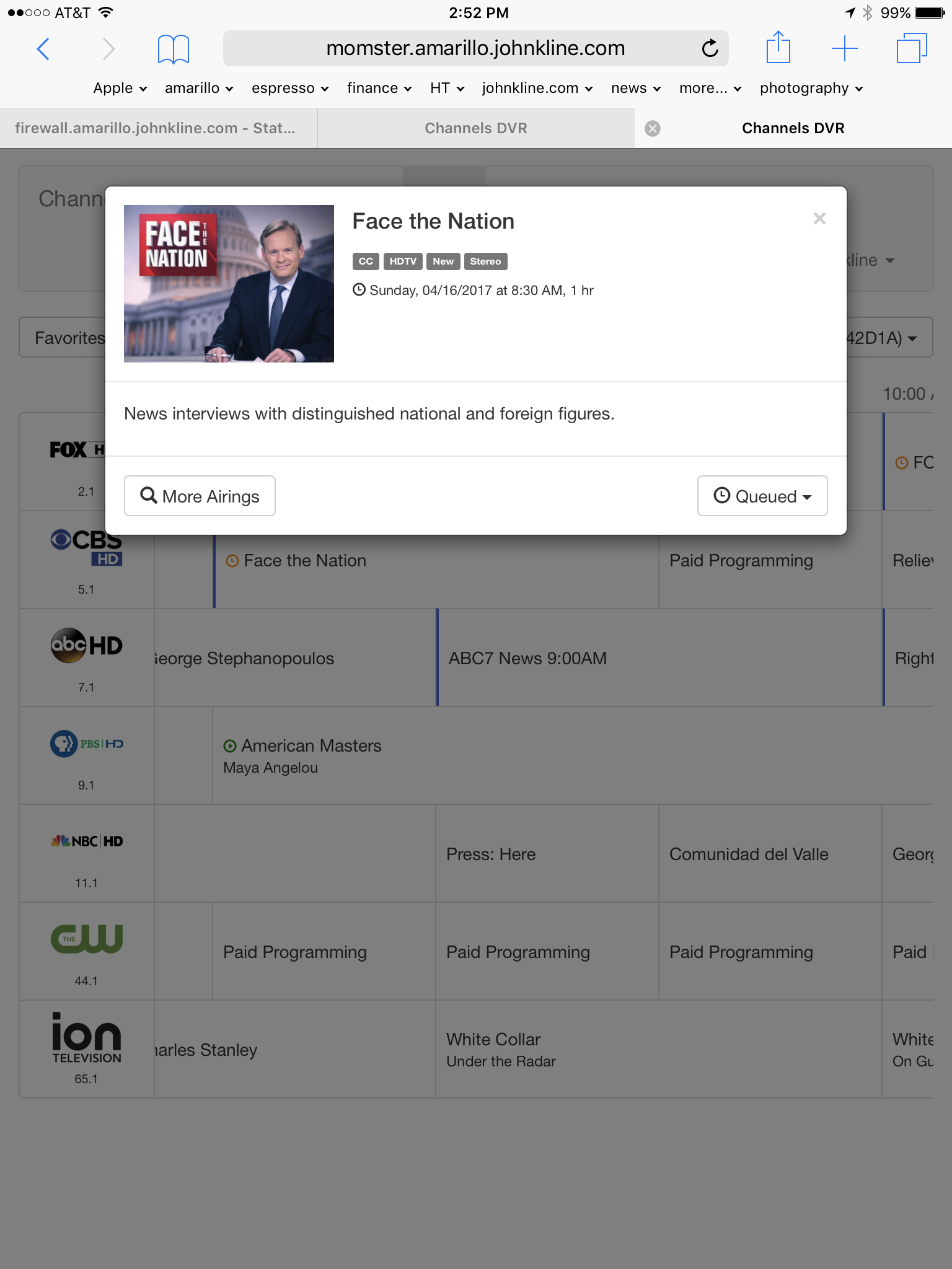

@tmm1 I see the exact same thing happening again on April 16.
(1) Face the Nation is in the guide at 8:30AM on channel 5.1. See photos 1 and 2.
(2) Face the Nation is not scheduled for April 16 at 8:30AM. Rather, the Monday 2AM half hour replay is scheduled.

Pausing and resuming resulted in Face the Nation being scheduled at 8:30 AM on April 16.
The log looks remarkably like the case I previously reported.
