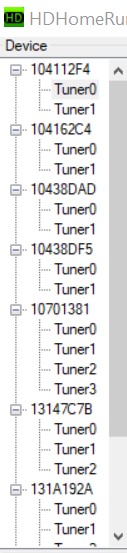

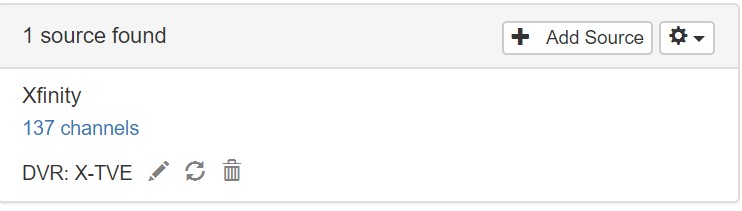

2019.12.27.0617 Channels DVR not seeing my HDHomeRun tuners only TVE ... The Clients see the tuners fine all on the same switch. Says I have to add them by IP. My other instance of DVR Version 2019.12.18.2234 sees all the tuners fine same switch,
My Tuners ...
I checked the logs nothing there the scan just will not pickup the tuners.
You will need to input the IP addresses by adding source and select HD Homerun Device.
