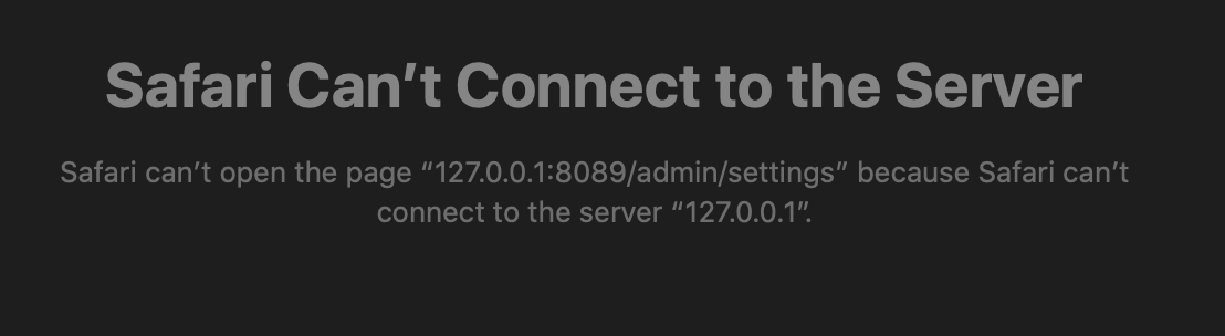

While I have had trouble off and on when I try to use "Away from home" the "at home" has always been flawless until now. Nothing has changed on my computer that I am aware of but now all I get is that Safari can't connect to the server. I have tried everything that I can think of with no success. I would appreciate any suggestions.

Sorry for the delay, I've been ill. No, it's going to 127.0.0.1:8089. I tried the ip you listed and got a slightly different message, I have included a screen shot of both of the responses, Everything was working fine until one day it wasn't.I didn't change anything at all.
You need to check the PC/NAS where your DVR is installed and make sure it is connected to your network. It seems to be having issues connecting to the internet.
My server is an external drive on my iMac. I have used this setup since I first subscribed and it has always worked flawlessly in may home. I have had troubles off and on accessing the system remotely but never locally until now. Can I reinstall the system without losing the shows I have stored? And how would I go about doing that?

Does it show up in the Mac menu bar next to the clock?
You can use our installer to uninstall and reinstall, then open http://127.0.0.1:8089/restore to restore backup
