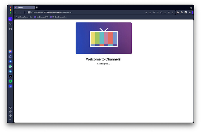

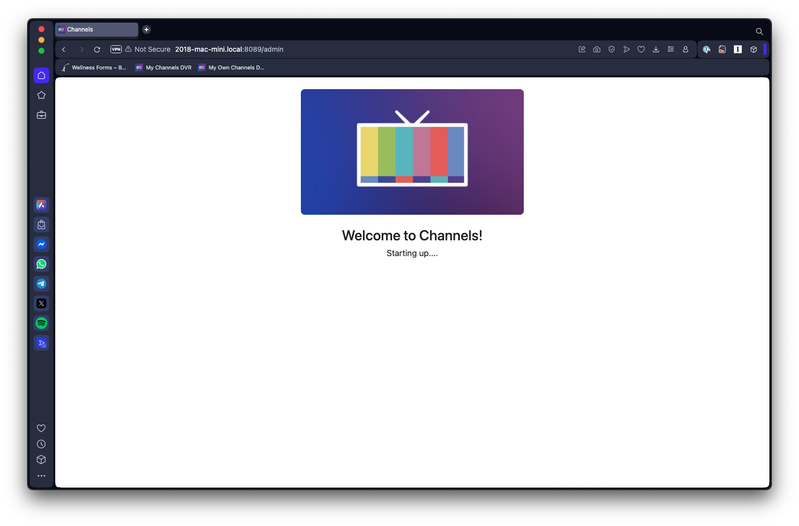

I was on vacation for a week and when I tried accessing my DVR remotely it said it could not access it. Bummer. I figured that my Mac mini had lost power and the DVR had not restarted when it woke back up (that's typical behavior). No matter, I came back from vacation and tried the Mac Mini. It was on. I tried the Channels DVR Server and it didn't seem to be functioning. I rebooted the Mac Mini (taking the opportunity to update the OS) and then tried to start the DVR Server. It is stuck on the startup screen. Check out the screen shot. It has been sitting here for a 20 minutes, maybe?
What should I do?
