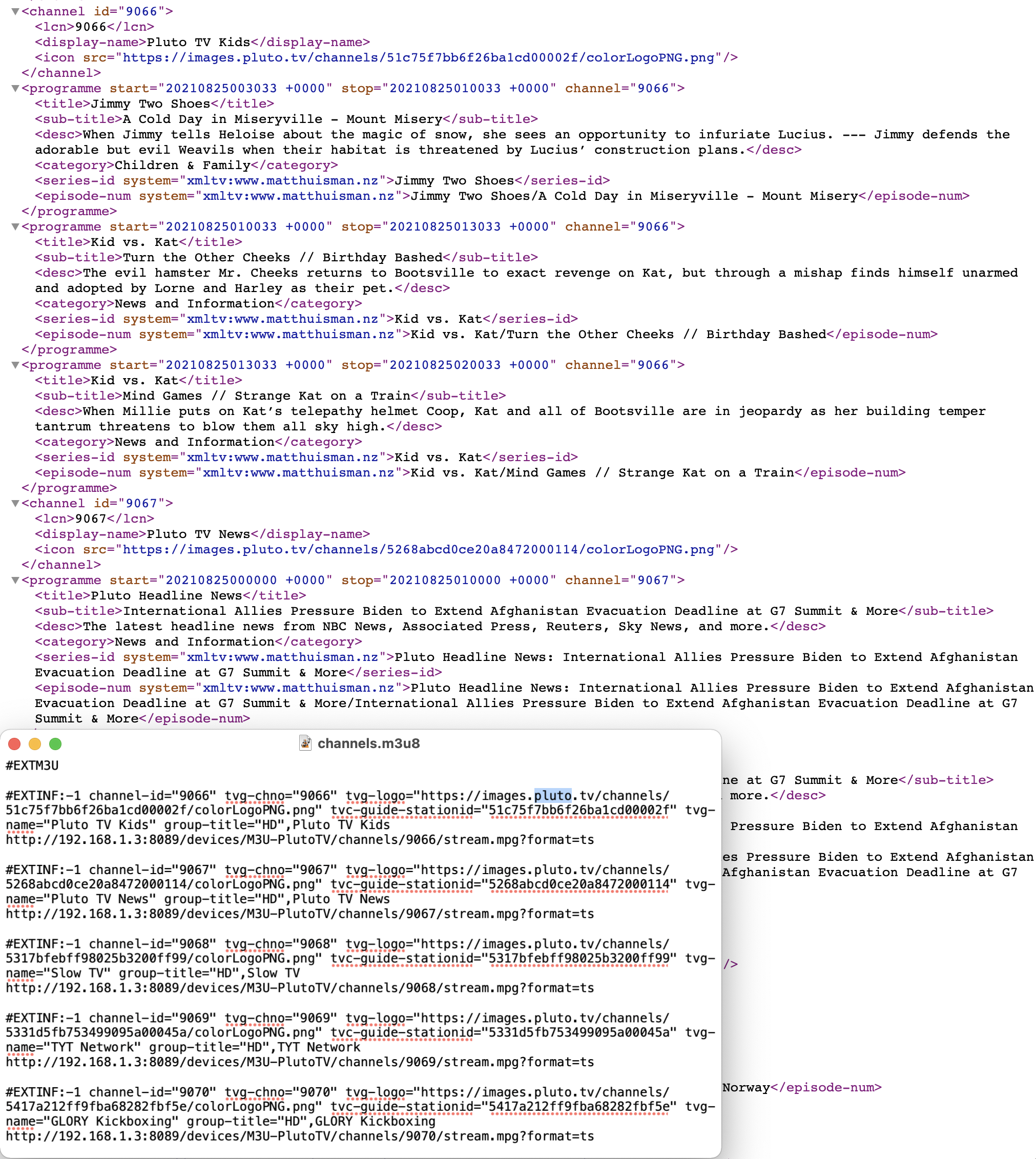

Really at my wit's end trying to figure this out. I'm feeding Channels DVR directly into Xteve using the M3u8 file autogenerated off the channels DVR link. All channels pull into xteve fine as available streams, but the channels will not map automatically when I try to tie it to the XMLTV File that Channels generates. I'm not sure why this is?
When I look at the XMLTV and M3u8 files, they appear to have a corresponding Channel ID and tvg-name but no channels will map. I can manually go through every single channel and map it, which is what I did initially, but I have over 400 streams now, and this process takes hours. Similarly, when I "scan" for channels in plex, all these new channels that have been mapped in xteve do show up, but most of them don't map correctly to the XMLTV file there either. Some of the channels that do map are incorrect (discovery channel maps as history channel, MTV as ITV, etc). Now that i'm trying to pull in Pluto content, I really would rather not go through 300+ streams and manually link map them. Does anyone have any suggestions? I'm posting this on the XTeve Github also because I honestly don't know if the issue is with Channels or XTeve.
See attached screenshot of xmltv/m3u8 files (this happens to be from Pluto, but this issue persists across TVE, Pluto, Locast, and custom streams.

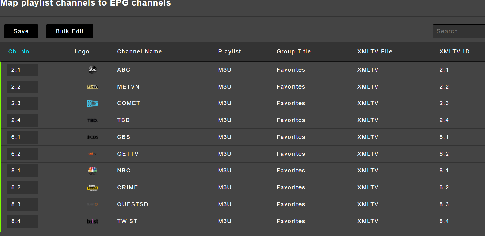

I only have a frame of reference from the last week or so of setting all this up, but it definitely automapped a few test streams I pulled off the internet before setting it up with Channels DVR. I'm almost wondering if there's some sort of cache of mapped channels to channel names and it's not triggering the automapping function because of that?
There are a few posts on github about issues with automatically mapping channels and even some bugs that look like the channels were changing based on lack of certain fields in the M3u. I'm wondering if perhaps this is what's causing this? Tempted to try the beta branch to see if that solves the issue.
I'm also wondering if this is what's going on. It's possible the M3u files I was using already had tvg-id tags and Channels doesn't provide that with their M3u. The only solution I can think of is to either manually map hundreds of channels, and hope nothing ever changes that requires me to map them again, or pull the m3u/xmltv files, match them up manually using an editor, and feed them to xteve.
I would really rather use links than raw files though, because if TVE links ever change, that means I have to do the entire process all over again and remap using the new M3u8 file. I'm not really sure why xteve can't map based on channel ID matches? That seems relatively easy to do. That's basically what I'm doing when I manually map the two files.
